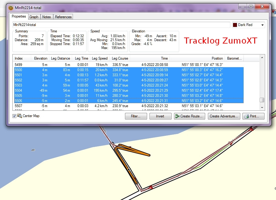

I think the problems with the speeds in the tracklog of the XT have to do with the software of the tracklog, if you look in the overview of the XT you can see the real max. speed that has been driven and not the extremely high speed that you encounter in the tracklogs. I have never had this problem with the Zumo 660, where you can see the actual speeds in the track logs. I have here 2 examples of the XT and the 660 on the same road route and that clearly shows what is not going well in the XT. Also an example of the XT when entering a ferry.
- Tracklog-fouten-ZumoXT-03.jpg (189.6 KiB) Viewed 8745 times
- Tracklog-Zumo660-.jpg (258.55 KiB) Viewed 8745 times
- Tracklog-fouten-ZumoXT-08.jpg (171.28 KiB) Viewed 8745 times

My XT Rarely does it.
My Xumo 590 and 660 both did it on occasion, My Garmin 60cx did it as well as did my both my Garmin eMaps.
It's just a fact of life when the GPS receiver receives an erroneous signal. On the surface software filters out the bad readings (you don't see your speed display jumping to 900 mph when just looking at the speed reading) but the log shows them.
I suspect it will get worse shortly as lots of talk about solar interference increasing.
..Tom
