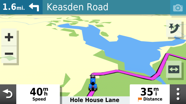

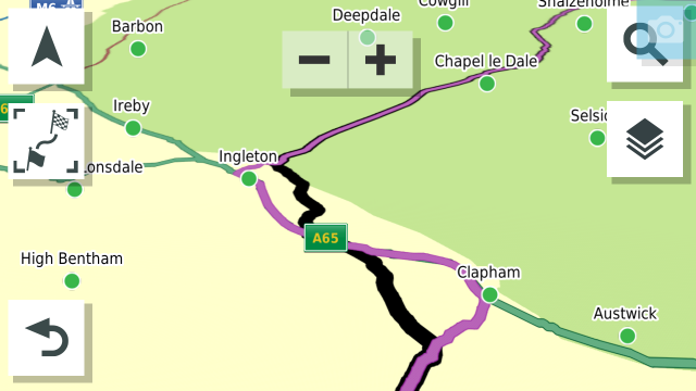

I have also travelled a full route having thought that it hadn't recognised the start point. I tapped skip, and indeed, the start point was still the next item, so I skipped it. The route navigated oddly, but issued all of the correct announcements. But I stopped at the roadside just before the route finished, and checked 'skip'. The next point was the second point, so I skipped it. In fact every single point that I had passed through and it had announced was still in the list of points that I could skip - (you can only see the next point, but as soon as you skip, it and then tap skip again, you can get the sequence. It was odd behaviour, and I believe that it had something to do with whatever happened at the start.
(nb you can also select edit route by tapping the top banner - this gives you the next shaping point and the next via point - but it doesn't tell you in which order they appear in the route).
jfheath wrote:Why is your route blue ? That is normally the colour of the tracks that have beenr recorded for previous rides.
BMcG wrote: Sun Sep 03, 2023 8:42 pmTrying out a custom theme.
I can't believe that even set on widest it is not possible to easily see a track hidden behind the magenta route line.
Garmin users have been using & extolling this trick for years & yet Garmin don't have a setting on the XT wide enough to make the track clearly visible :roll:
I have a couple of themes that I modified. I only changed two sections in Garmin.kmtf - I copied the kmtf file and called the new file JFH Garmin.kmtf - then edited JFH Garmin.kmtf. These are all located in Internal Storage/Themes/Map on the Zumo XT
One section was the name of the theme. I simply put my intitials in front of the original. This section is at the top of the file.
<TITLE>JFH Garmin</TITLE>
<DESCRIPTION>JFH Garmin Theme</DESCRIPTION>
<CREATOR>JFH - Garmin</CREATOR>
<Version><Major>1</Major><Minor>00</Minor></Version>
The other was the MAP_TRK_CLR section - at the bottom of the file. I changed the scale from 1.00 to 3.00
<STYLE field = "MAP_TRK_CLR" scale = "3.00" >
This works best for me if the Track width is set to medium. It looks odd when redrawing, but it makes the track slightly wider than the route, so if it is set as a high contrast colour (I use black), the track can just be seen peeping out from under the route.
It isn't perfect, but it is enough. Two screen shots - the track is odd here, cos I used a the route sent to me by @Zumek when I was asking for some information about Kurviger. So the XT has drawn the route, but the track was drawn using Kurviger maps. The track doesn't appear as a thin black line either side of the route - highlighting the difference in the maps. I always use Basecamp - identical maps - and I get a thin black line either side of the route.

I believe that starting the route at the closest entry point in this way, beyond the first segment, is similar to what happens in reality when a recalculation of the route ocurrs when actually riding a more complex route.
I think the issue may only occur only after a deviation from the route or skipping a point, so after a recalculation.
My guess is that after a deviation/skip, when the XT is attempting to calculate the remaining route summary screen it somehow tries to recalculate the beginning of the route so it can work out the remainder of the route but the addition of the shaping point somehow corrupts the calculation.
& if you think that is weird
everything will work perfectly if the final fifth end Via point is within less than 1 mile of the previous fourth Via point! :shock:
If the fifth Via point is 1.1 miles after Via point 4 the popup summary info screen will display the blue spinning disc.
Another way of looking at this is, if I want to avoid the issue & use auto-recalculation, then I can't use shaping points (like that is going to work!!) :lol: :roll: :lol:
