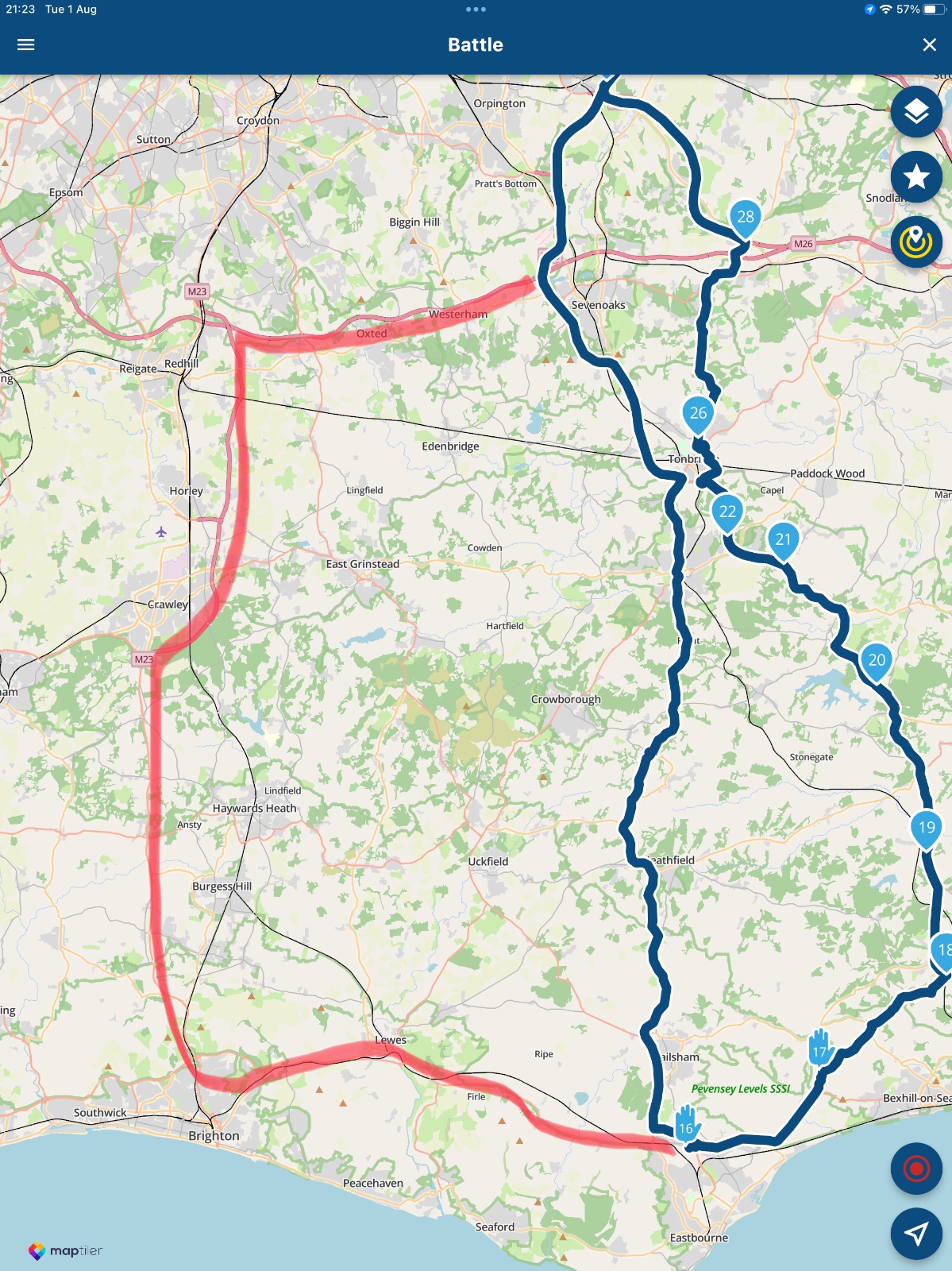

Just to jump on this thread I also experienced routing weirdness last week. On the map the blue line is the route I planned in MyRouteApp. I deliberately left out shaping points before number 16 thinking (wrongly as it turned out) that the XT would probably take that route. However, it decided that it was quicker (!) to take the route indicated by the red line which is over 20 miles longer. If I put the route from the M25 into Google maps it uses my route as it is the quickest and shortest so I have no idea why the XT thinks it’s route is quicker/shorter/whatever! I actually ignored it once I realised what it was doing and took a parallel route to 16 which gave me a bit of XT RUT before it calmed down and got on with it. Weird!
Re: Latest XT routing weirdness
The emphasis by the XT on faster roads is truly frustrating. Its algorithm identifies roads with the fastest travel speed that will get you to the route point without consideration of slower roads that will get your there quicker.
Peobody wrote: Tue Aug 01, 2023 9:13 pm The emphasis by the XT on faster roads is truly frustrating. Its algorithm identifies roads with the fastest travel speed that will get you to the route point without consideration of slower roads that will get your there quicker.
Took a while for me to learn this, last year I guess. I pressed Go Home knowing full well how to get there. After all, I was on the road I live on, about 80 miles away from home. You'd think traveling down the road you live on would be the fastest but no, the XT wanted to get on roads with faster speed limits. It wanted me to go some 50 miles and 45 minutes longer to get home "faster". That's when I began searching for a way to choose neither faster nor shorter so it would calculate "normal" :P . Haven't found a way to yet. I wish Garmin would fix this bug.
