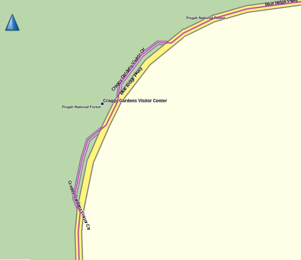

The image below in from my BaseCamp route. Unnoticed by me before the ride was that the route diverts through the parking areas of the Craggy Gardens Visitor Center. There is no route point there. My XT and my buddies Nav VI added the Craggy Gardens Visitor Center to the route as a via point. The routing by BaseCamp through those parking areas is odd but I can see how the parking areas could be interpreted as the right lane of the road (direction of travel is N to S). I sure don't understand the addition of the via point though. Anyone ever experienced that?

Yup, routing anomalies are common. My issue is the fact that a via point at Craggy Gardens Visitor Center appeared in the route on the XT. I did not add it and it is not in the BaseCamp route that was sent to the XT. This route recalculated at the start of the day due to an errant screen tap that changed a shaping point into a via point. I suspect that recalc is when the Craggy Gardens via point was added. All of my route point names were prefixed with a day number and route point sequence number (eg: D1_07_RoutePointName). The Craggy Gardens via point was not prefixed.

I can't make sense of what could have happened. There is no route point near Craggy Gardens in the BaseCamp route so I don't see how it could be a shaping point changed to a via point. The odd routing through the parking areas by BaseCamp would appear related to the XT adding a via point. When I have a few dedicated minutes I intend to resend that route to the XT and check it for a Craggy Gardens route point. If none, I'll force a recalc and see if it adds it again.
BTW, I looked on my XT in Where To > Saved for the Craggy Gardens via point but it is not there. I guess this makes sense. I would only have been added to that list during import of the route had it existed in the first place, right?
Re: Satnavs added a via point to a route!!!???
I now think that I am wrong about my XT adding a waypoint. :oops:
I have been unsuccessful at duplicating the added waypoint. What I saw that now makes me think I was wrong is navigation instructions that say "Keep right on Craggy Gardens Visitor Ctr". There were two of these at the entrance to each parking area. My buddy with the Nav VI stated that he had to skip a Craggy Gardens waypoint but I now question whether that was actually the case. Regardless, at the time of the ride I was unaware of the route going through the parking areas so the navigation instruction appeared to be directing us to the Craggy Gardens Visitor Center as if it was a via point. @rbentnail and @jfheath, Please accept my apology for sending you on a wild goose chase.
