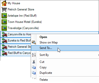

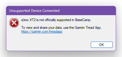

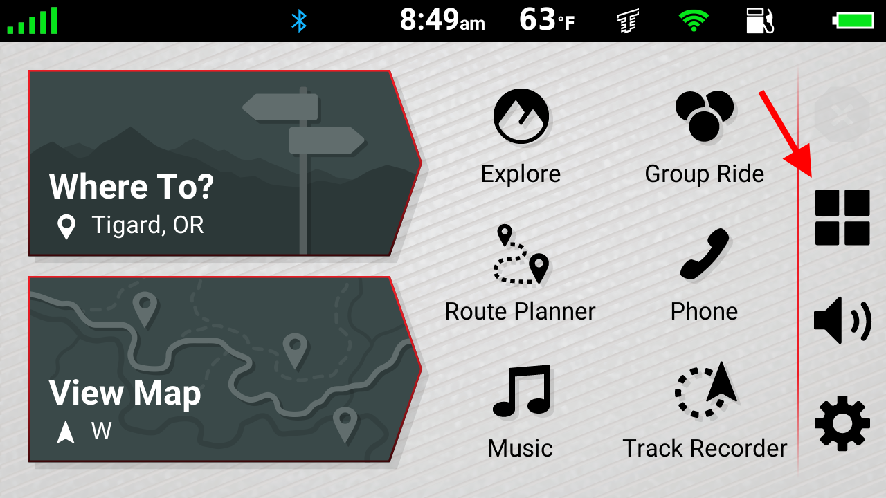

When you fire up BaseCamp with the XT2 connected to the computer, you will get this dialog. Just click OK to dismiss it.

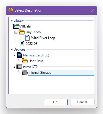

To transfer my routes to the GPS, I select the four routes that make up my trip, right-click on one of the selected routes, and select "Send To..."
Choose "Internal Storage" on the XT2.

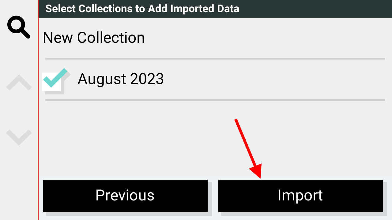

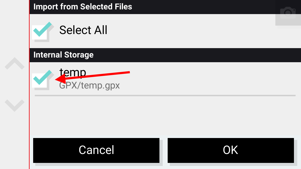

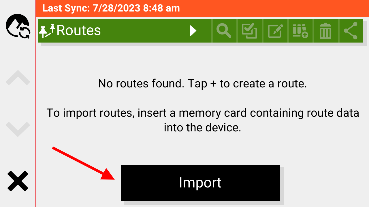

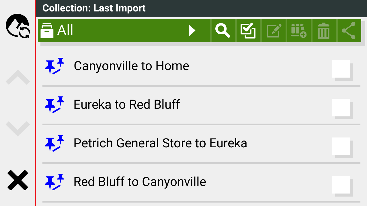

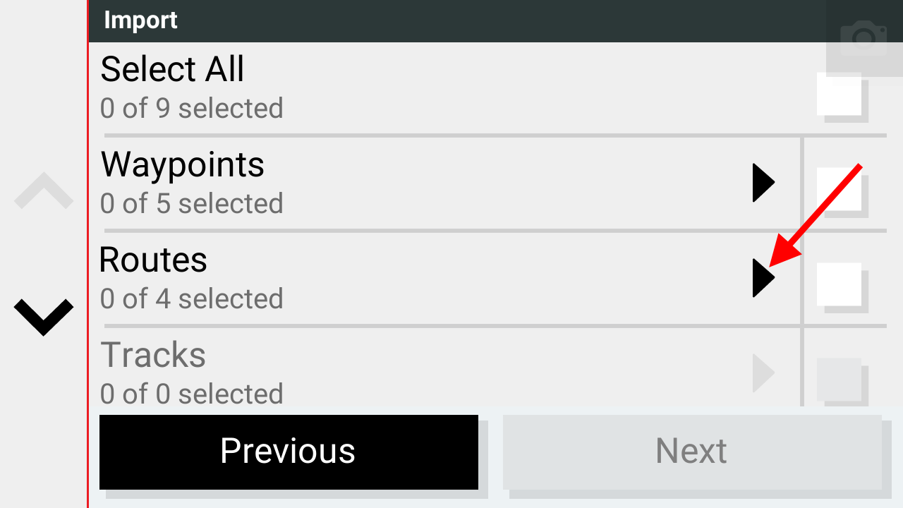

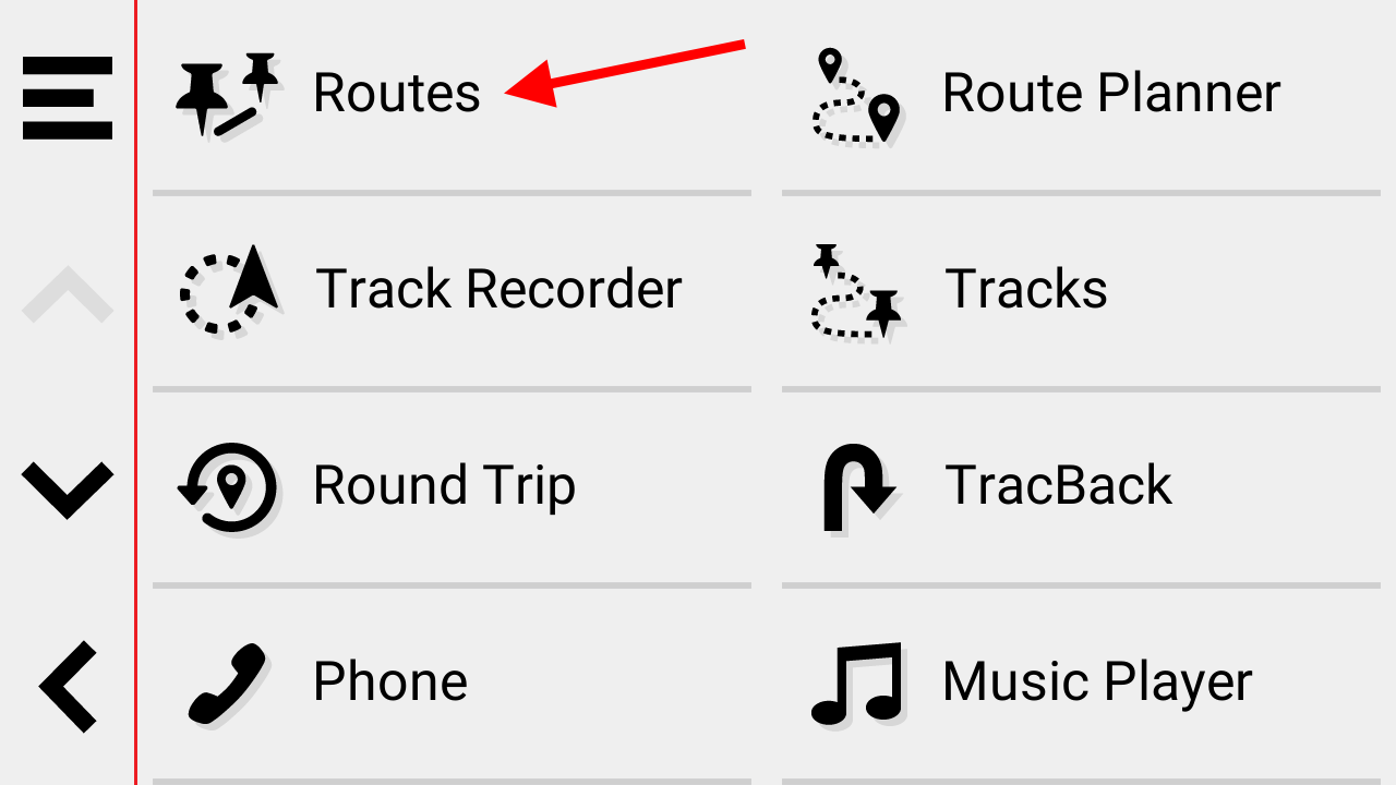

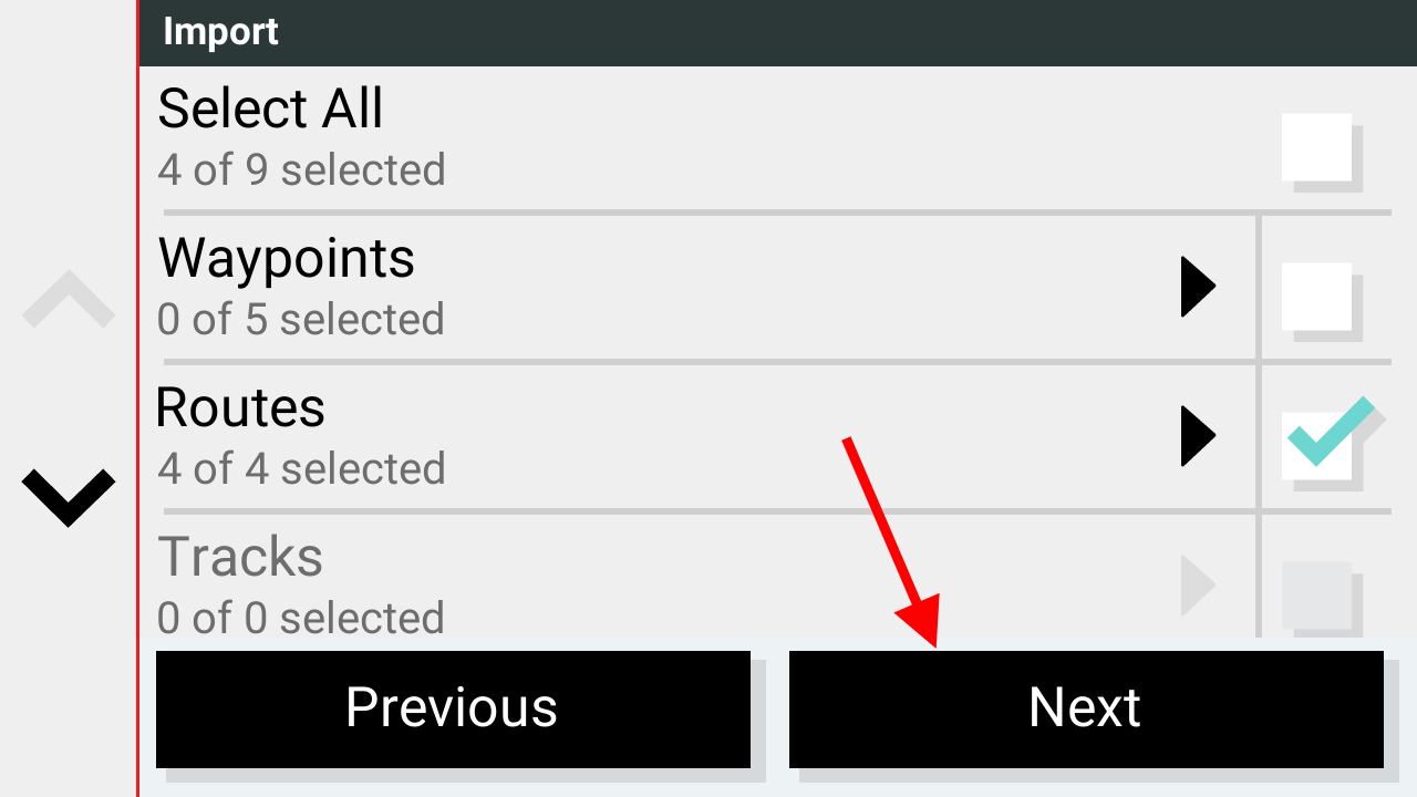

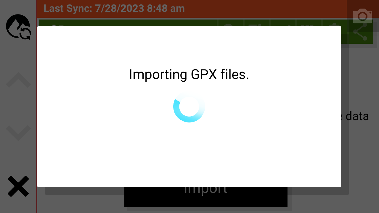

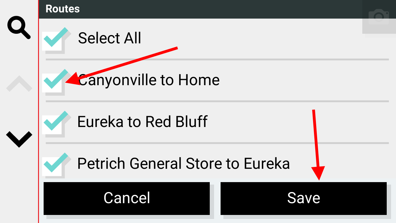

After that, unplug the XT2 from the computer and let it boot up. Then do the following on the device.
Hope this helps. I'm far from an expert, but if you have any questions about the process I used, feel free to ask.
Re: Opening a route takes a very long time
Wow - many thanks for that.
Interesting to see that they no longer call the App 'Trip Planner', but have reverted to using the term 'Route Planner'. That leaves Trip free to refer to whatever it is that convert a track to in ordert o make it navigable.
Also there are indications of where the data is stored on the XT2 itself.
Thank you for doing this - having never seen one, it is quite revealing !!

jfheath wrote: Fri Jul 28, 2023 5:58 pm Also there are indications of where the data is stored on the XT2 itself.
I'm a retired software engineer, so when I see stuff like that I start to think about how it works.
I suspect that when the user taps the IMPORT button it's probably just searching the device file system for any file that has a gpx extension. That leads me to notice that it's in the same place on both my 550 and the XT2. Now I'm thinking, the "Send To..." option in BaseCamp isn't doing any magic, it's likely just a wrapper around "export the selection to temp.gpx and copy to device."
So, I copied temp.gpx from the XT2 to my computer, went into BaseCamp and exported my four routes as GPX, and used BeyondCompare to compare the two files. The only differences were that the waypoints in the file that I exported explicitly had two WaypointExtension elements, one in the gpxx namespace and the other in the wptxl namespace.
