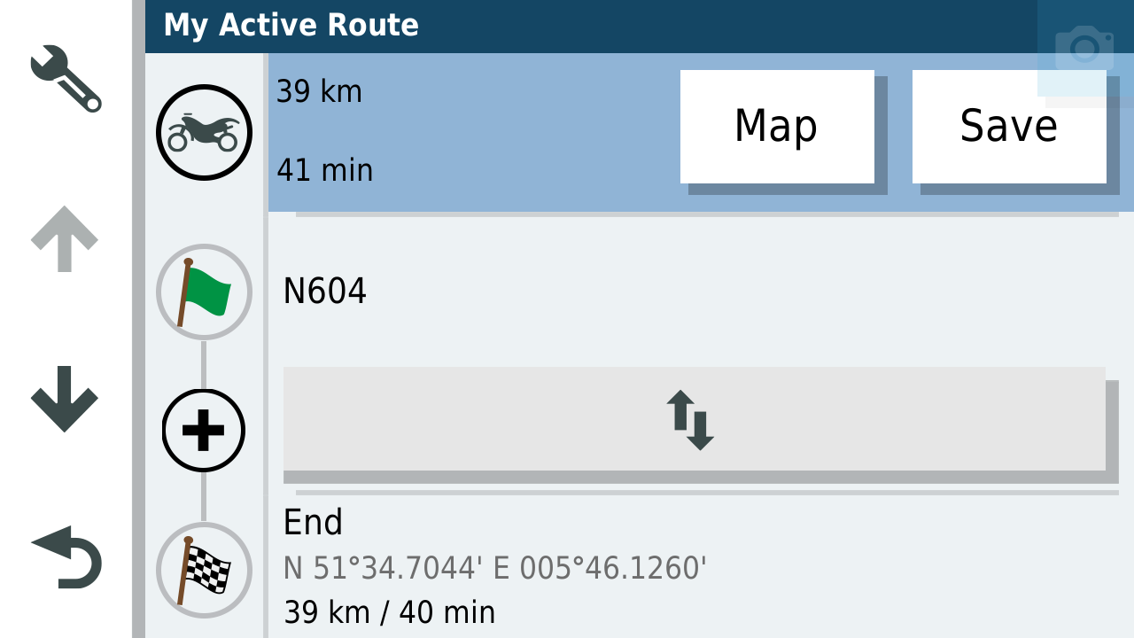

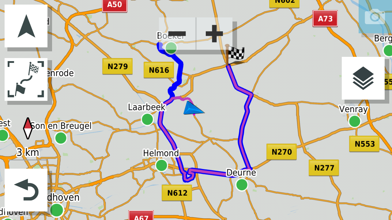

If I would have to describe it I would say: It is trying to get you back to the route as fast as possible. I hope the screenshots will make it clear. (Blue is the original track that the trip is based upon, Magenta is the active trip.Peobody wrote: Wed Jun 07, 2023 1:23 pm What does it do instead, recalc only to next route point then continue with the preplanned route?
If so, how were you able to determine this?
Note: A trip from a track has no route points, only a start and an end point.
No. Dont think it plays a role. Just something I noticed when viewing the trip file.Peobody wrote: Wed Jun 07, 2023 1:23 pm Is it your thinking that editing this byte will prevent the 'recalc to then end of the route' annoyance for routes not created from a track?

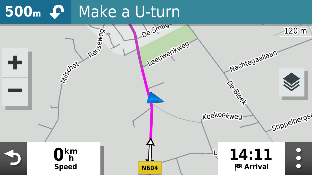

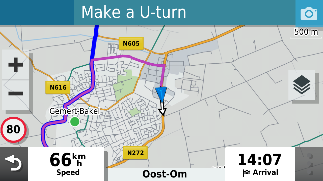

I found a very definitive tell tale sign that the navigation is displaying RUT behaviour. Turn off U turns. Deviate and let it calculate a way to take you back by using side roads, laybys, housing estates etc. After it has done a couple of these, stop at the side of the road and look at the route that it is trying to get you to follow. It will contain all of those housing estate / sideroad / layby 'turn round' sections. Why, if it is calculating a new route would it do that?
The answer is that it isn't calculating a new route, it is suprgluing a new section to get you back to the closest point of the original. And that is behind you. And that is exactly what happens when you deviate from a tracktrip. There had to be one key difference that distinguished an XT route from an imported route. So I set about proving that an already tested RUT route would not display RUT behaviour using identical saved Waypoints, If the route was built in the XT.
And that was why I was so excited about that single byte change. It seems to be the single thing that makes the XT behave as if it is a tracktrip, and behave as if it was created as a normal route in trip planner.
And that was exactly what we were looking for. @Frankb found it. I'd already done the testing of various routes so that I knew when it would RUT and when it wouldn't
