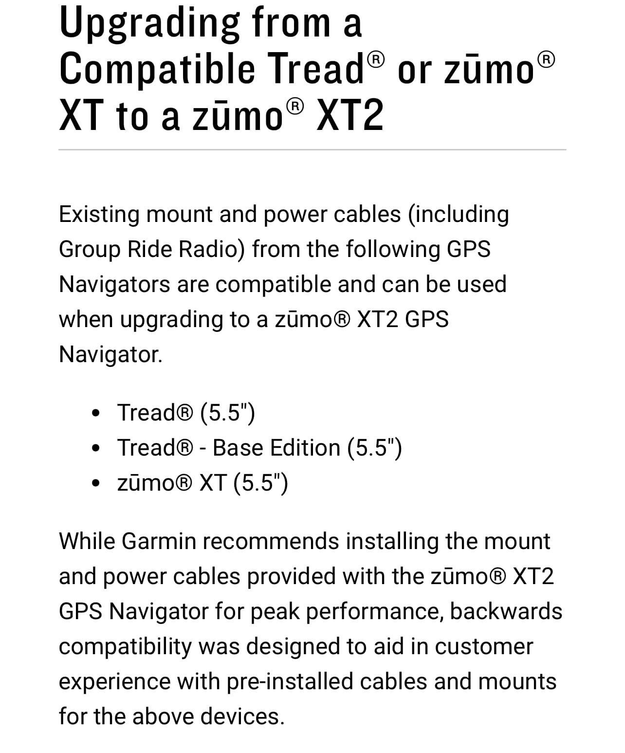

According to that the Garmin tread and the Zumo XT2 are backwards compatible with the Garmin zumo xt mount
