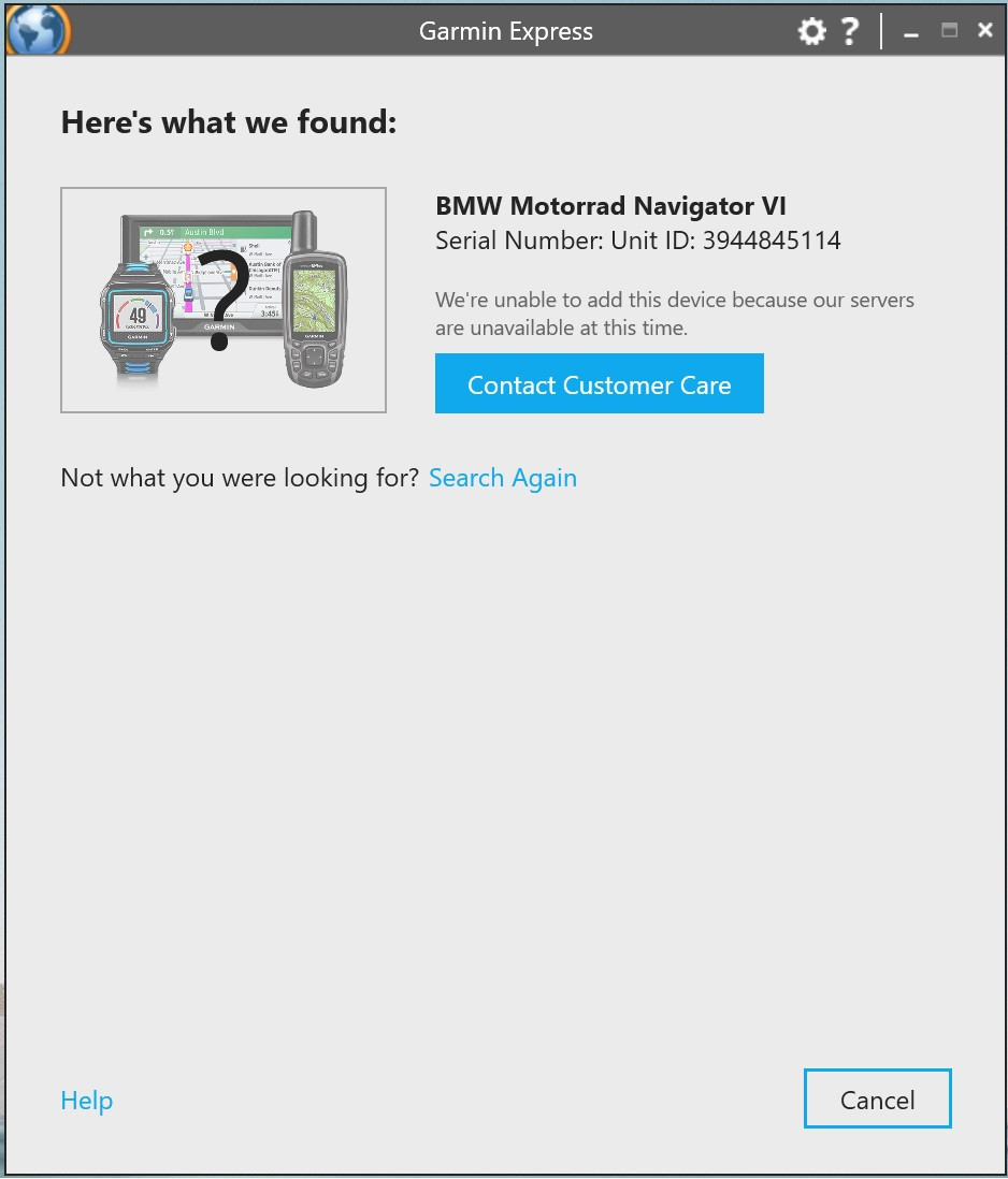

New version of Garmin Express available. BUT with the bug (at least for me). During update via Garmin Express, installation failed and I was not able to run Garmin Express anymore. I uninstalled it from PC, downloaded installer from Garmin web:
https://download.garmin.com/omt/express ... xpress.exe and tried install it again.
Now Garmin Express is installed, but I can't add any of my device (NAV V and NAV VI). There is an error message:
GE
GE

I reported my problem to Garmin, still waiting for response. V.7.16.1.0 available for download today, but it did not fix my issue - NAV V nor NAV VI recognized by Garmin Express. Avoid update if you can until they fix all bugs.

I think it's an issue with the new CN NA map. After I had the error, I downgraded to v 7.15 on one computer, did not update from 7.15.2.0 on another. Using an XT and a 590, all combinations gave the same error while trying to install on a PC - "Map changes failed"
EDIT: The failure to update the map on a computer is a map problem, not an Express bug.
Garmin is aware of the issue, see https://forums.garmin.com/apps-software ... 55#1565355. We just have to wait for a fix.
