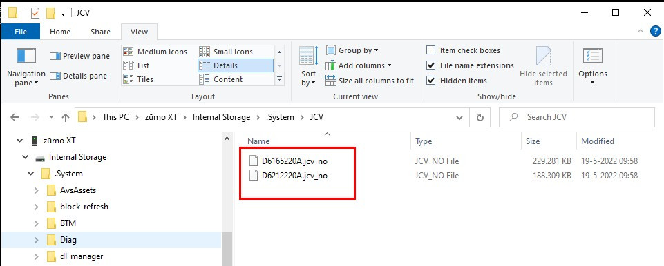

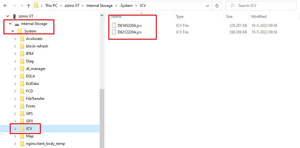

If you feel confident 'messing' with the files on the XT, you could try this:
- In the folder .System\JCV you will find some *.jcv files.
- They contain the info needed for 'Junction View'
- Simply deleting them, or better renaming, will result in the XT not finding the info about Junctions.
- What happens? I REALLY don't know. The worst thing: Could be that it renders your XT useless. The best thing: You disabled it.

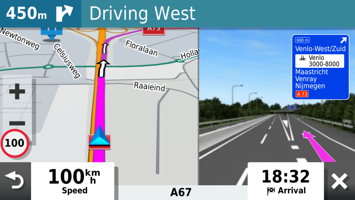

Just ran a quick test with the 'Indoor simulator'.
I can confirm:
- Changing to another map, like Open Streetmap, wil disable it.
- Renaming the *.JCV files will also disable it.
- And good news.. Renaming them back to the original names will restore it.
I agree with anyone that messing with the .System files can be tricky, so please make a backup copy before trying.
See the screenshots I took.
City Navigator with JCV files:
Open street map: (Look at the speed! It's only the simulator, don't worry)
City Navigator with renamed JCV files:
