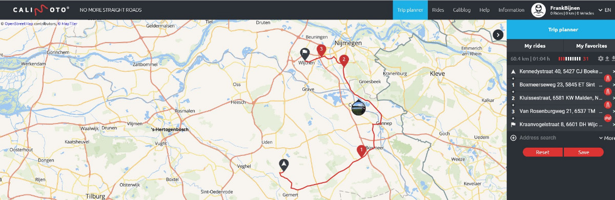

Re: Calimoto GPX Route that works for Garmin XT
Hello Omobono
I like Calimoto. Because it offers a lot of interesting routes, at least in the Netherlands and Germany where I live. But because of the limitations (see below) I always recreate the route in Basecamp, and some tools of Javawa, to get it working correctly on the Zumo XT.
Limitations:
- I am unsure what Map Calimoto uses, in the top left corner it shows 'OpenStreetMap. But certainly it is not City Navigator. And even if it was City Navigator, very unlikely the same version as on the XT.
- Calimoto makes no distinction between Shaping and Via points. (Shaping are DONT alert on arrival, Via's are DO alert)
- The exported GPX file contains only:
- The starting, ending and via points that you created in Calimoto as Waypoints. Standalone, not part of route.
- A track. This track is more or less usable on the XT, but has no Via, or shaping points.
- A route. But... This route does not have the Via Points that you created in Calimoto, but instead it puts 'Intelligent via points' on every junction/roundabout. I say Intelligent because that is the term that Calimoto uses, but I think they are on the worst place were they can be. (See the 2 attached images) So if you ask me. Use Calimoto to get good ideas (use the routes that they offer as a starting point for your own routes), but dont use it as a route planner for the XT. If you dont like Basecamp try Kurviger (https://kurviger.de/it) or Myroute (https://www.myrouteapp.com), although they also have there limitations.

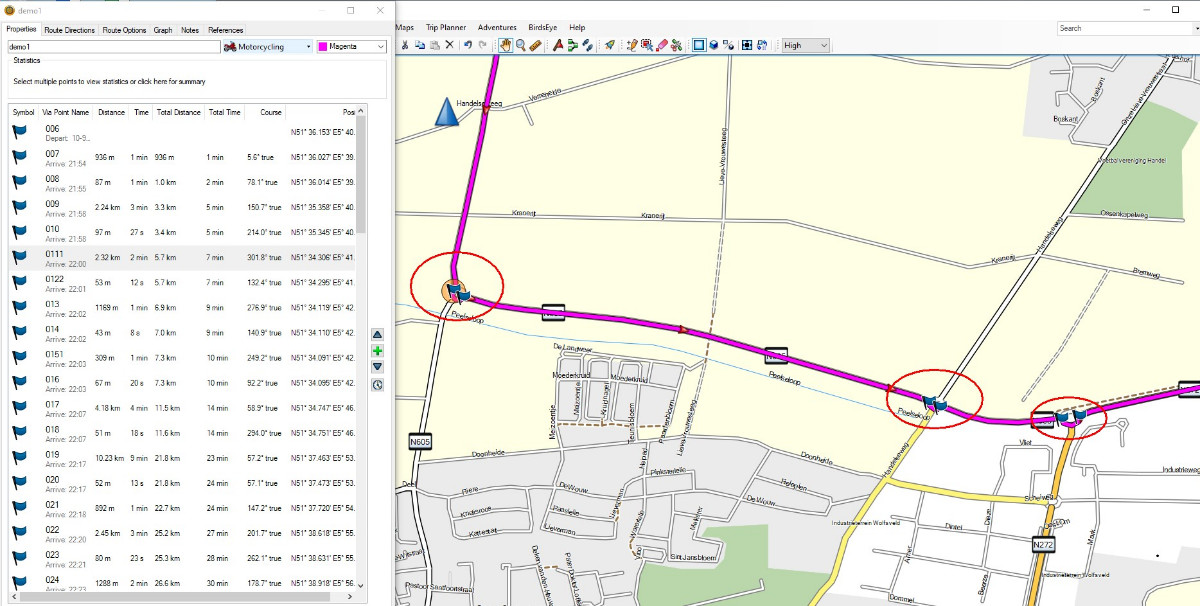

I agree with FxWheels that Basecamp is the best when you use a PC/Laptop.
Please also look at the excellent document that Jfheath prepared. 'Zumo XT and Basecamp, everything that you need to know' on top of this forum.
What you said about the XT directing you to the middle of a field, typically happens when a) you are not using good maps b) you are using different maps on your planner than the XT. c) You place your Via point wrong. Not precisely on the road.
Using Basecamp these problems can be overcome, with other software it is questionable.
For a Viapoint to show up on the Xt to select as a destination it needs to be 'Alert on arrival' in Basecamp! This is what Jfheath calls a Via point. You are using (I think) Shaping points, or 'dont alert on arrival'.
