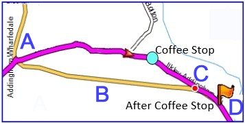

Here's an example:
I have a route plotted on the Magenta Line. There is a shaping point called Coffee Stop. There is a Via Point at Point D. The yellow road from a to B to C is a bypass that avoids the village in which the coffee stop is situated. B is a point somehwere about mid-way between A and C. C is not a route point at all, it is the place where the original route meets the bypass. I am assuming that the satnav allows me to perform a U turn.
I am approaching from the left of the image. At A, I decide that I don't want to stop for coffee, so I head down the bypass towards B.
As soon as I do this, the satnav will recalculate the route, trying to get me to visit the next route point in its list - the shaping point at Coffee Stop.
Perform a U turn, I ignore it and continue
Perform a U turn ... ditto
At around point B, the satnav stops asking me to perform a U turn and instead draws a magenta line on the road ahead towards point C
As I approach C the satnav springs into life again and tells me
In 1/4 of a mile, turn left at junction It is still trying to get me to the coffee stop shaping point (I haven't visited that point yet, and it is the next point in the satnav's list).
As I reach C, I do not turn left, and continue ahead. I am now on the magenta line which is plotted from the Coffee Stop Shaping point to the 'After Coffee Stop' Via Point at D. Because I am on the route and I have not missed out any Via points, the satnav continues navigating me to the next route point. The Via Point at D.
Arriving at After Coffee Stop on the left.
Had the Coffee stop been a Via Point, it would have kept insisting that I go back to it. Even though I am on the magenta line going towards D, and would still continue trying to get me to go to the Coffee Stop even after passing D.

Here's an example:

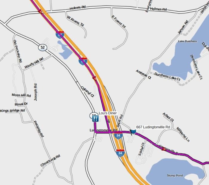

I am working on a new trip and am trying to incorporate the 'coffee shops as a shaping point' trick described by @jfheath. I have encountered one that I know will trip me up if I can't fine a creative solution so I'm here hoping for one. The problem is that the coffee stop (Lou's Diner) is off of an interstate exit to the left with the route off that same exit but to the right. This will be on day three of the trip so I am hoping for something that will remind me to take that exit even if I decide to skip coffee.
Re: Adventurous route changes to fastest if point missed
Exactly what @sussamb said. Make sure your coffee stop is set to not alert (Shaping Point).
In the diagram above, the satnav will speak out - "Approaching turn right for no coffee". Once you pass the via point and the satnav may give instructions to get to the coffee stop (depending in the nature of the junction), but if you turn right and the coffee stop is a shaping point, it will continue navigating on the rest of the magenta route.

Thanks guys. I don't know how well that will work with spoken navigation turned off though. I should have mentioned that in my original post. Next week I am going to try to create & ride a test scenario on roads close to home.
How do you turn off spoken navigation ? The only way that I know is to turn down the volume in the mixer or to mute the XT altogether.
In both cases you will still get three tell tale signs.
1 The orange flag on the map of the approaching via point
2 Possibly the white marker on the plotted magenta line indicating a direction change
3 The top bar of the XT screen will show the same message as text.
