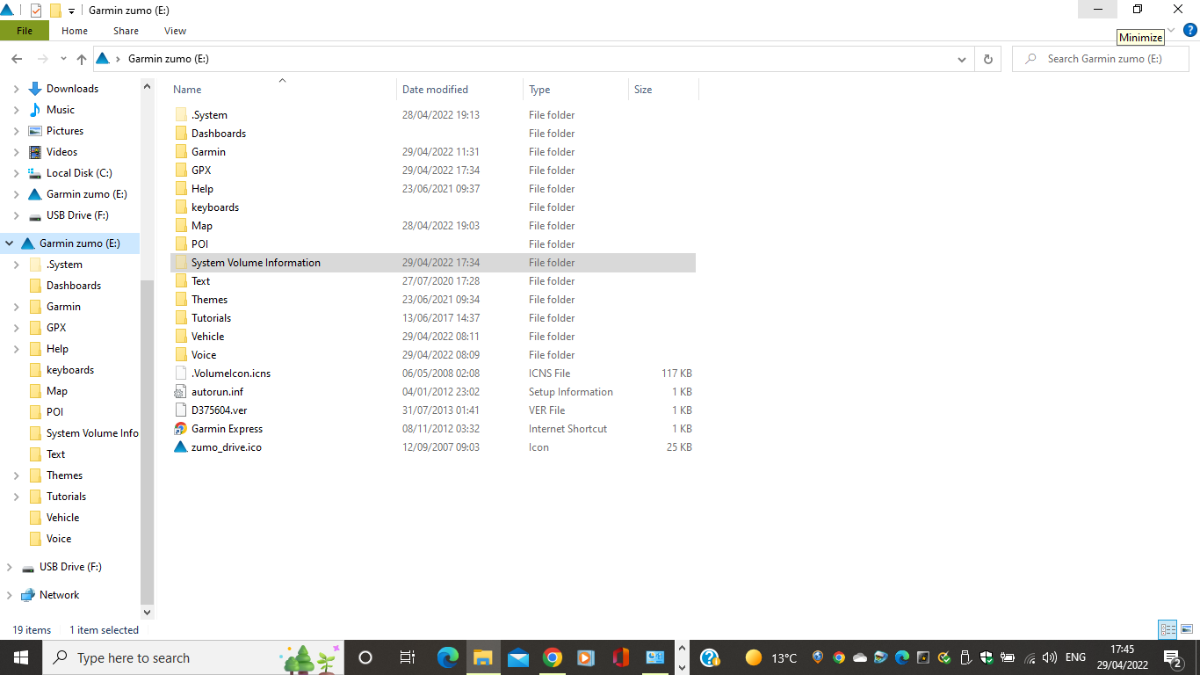

I have done all of the above and as you said it displays two drives, E & F.
The F drive contains the folders mentioned but looking at them there is only one file in there of 2.7ish Gig and that is from the update yesterday.
Hope this makes sense as I am not very computer literate!
I have put a screenshot of the page on.
Screenshot (18).png (203.74 KiB) Viewed 6107 times
download/file.php?mode=view&id=1229

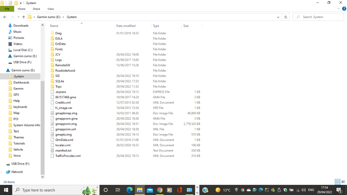

If I open .system this is what I see.
Screenshot (19).png (227.95 KiB) Viewed 6107 times
Re: Internal storage on Zumo 390LM
You may need to compare with someone else who has a 396, but from your data I would suggest that this may be about right.
It would seem that the 396 has only 8GB of internal storage since you have only 179Mb of 7.13Gb. (Whatever the value is for memory (eg 8GB) you get much less than that for actually storing data, once the system has formatted the space to make it usable. Most of it is used for maps and all of the operating system files.
But there is enough memory there for the system to work. If you want more for music or for additional maps, use an SD card.
Some of the files can be removed, but you don't gain much. eg - Voice, Vehicle, Keyboards. There is no need, but if you choose to do that then always take a backup of any folder from which you delete files - just in case you need to put them back.

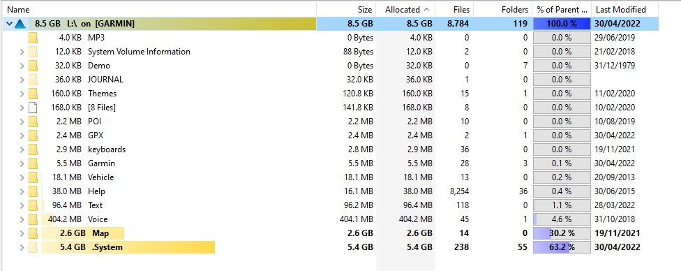

Below are three screen shots of my Directory tree for my 595. It shows you where the space is being used.
Zumo 595 Level 1 shows the Main Internal Storage - the folder names on the left and the amount of space used. So in total mine has used 8.5GB.
But I have a few OSM maps installed which take up a fair bit of space. These are in addition to the same maps that you have installed. Most of them are not worth looking into, they take up so little space.

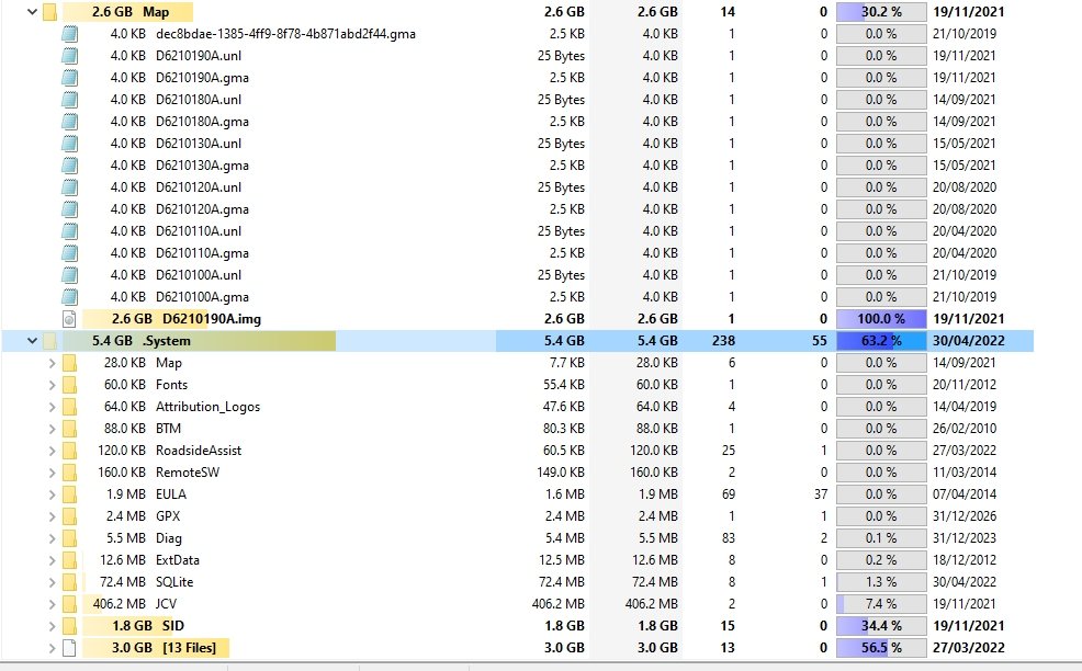

Zumo 595 Level 2
- shows the expanded view of the Map folder and the .System folder.
The one at the bottom is identical to the map file that you have and occupies 2.6GB. All of the others are unlock files for maps that I don't think I have now !
Down at the bottom is a folder for SID files. I haven't got a clue what they are for, but the names are related to the map file names.
Under that is a folder that contains 13 files and which occupies 3GB. So that it worth looking at.

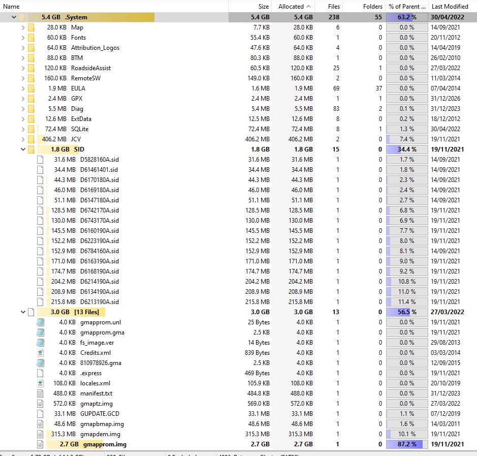

Zumo 595 Level 3
These are the files that are within the .system folder
These are mainly map img and unlock files. However, GUPDATE.GCD is to do with the system firmware. It is what is used to install firmware updates, and once it has been used, I believe that it is no longer needed, and could be stored somehwere else out of the - on your computer perhaps. Suitably labelled - because there is nothing to distinguish it from later update files which have exactly the same name.
I cannot see that you have such a file though.
The only thing that is likely to grow in your file system is the GPX folder and Archive folder. These contains the track logs of where you have been, but the amount of space that they occupy is self limiting. GPX logs build up in size as you ride along. When the file reaches a certain size it is placed in the archive folder, and a ne wlog file is created. But it only allows the latest 20 to be stored, earlier ones are deleted. I've just looked at my logs from the 595. They never exceeded 3Mb, and there were only ever 20 of them. So that is only 60Mb and you have 179Mb free. So it isn't going to cause a problem.
If you have musice files, shift them to the SD card - \Garmin\MP3 - rather than having them in Internal storage. Its best to have the maps in internal storage if they will fit. The access is faster.
Garmin Express will let you know if there isn't enough room for a map in Internal Storage, and it will then put it (or some of it) onto the SD card instead.
Tree Size is a very handy program for looking at your folders and seeing where all of the space is being used in your system. I use it a lot. I have just checked, and there is no longer a free version available, although there is a free trail version.
But Wiztree is well regarded, and I've juts downloaded that to give it a go. Google it.
