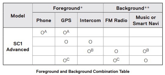

This multitasking combination table is the key:
* Two audio sources in the foreground can be heard simultaneously with the
same volume level.
** Only one background source can be heard at a time while listening to an
audio source in the foreground.
A. GPS instructions can be heard during phone calls and the volume level of
both audio sources can be adjusted using the headset.
B. GPS app directions will be heard in the background during intercom
conversations.
C. The FM radio will be heard in the background when GPS instructions are
heard.
I've been success in some scenarios to no interrupt the music - it was FM radio, this is only "music" background not interupted during instructions from XT (ie speed camera alert), Oc combination in the table.
P.S. XT is central hub I agree, but doesn't matter if iPhone is connected to Sena directly or not (I have iPhone paired and connected simult. do XT and Sena), same behaviour if I disconnect the iPhone from Sena (Schuberth SC1A)

OK guys I've figured out what is the behaviour and WHEN is multitasking available during your ride. Let's confirm mine pairings that realy works:
According to the table from the Sena manual the device type phone has always TOP priority and it's always as foreground, only foreground in fact, you NEVER PAIR XT as phone device, always pair as GPS to get multitasking - I mean uninterrupted music in your ears. The combination the phone call and GPS should work as well (table Oa options), but this scenario I did not test.
I recommend firstly power-on Sena and XT after. Try turn the FM radio ON and let's test some camera speed alerts or smart notifications - it will be mixed into the radio (radio volume level can be set via phone application).
Let's describe how to listen the music from phone without interruption. Because the XT is not making mixing (multitasking) it is impossible (without chaning the XT firmware). See the multitasking combination table, we can mix GPS and music via Sena. Because the direct pairing of the iPhone to the Sena we get the better audio quality (comparing to GPS device profile confirmed by Sena's local distributor but I cannot hear difference) and we can play the music from the iPhone directly to the Sena as secondary audio source which will not be interrupted. Benefit: you can still control the tracks from XT's Music app. I do not use spoken nav. instructions, only alerts of cameras and POI and smart notifications.
UPDATE:
- iPhone <-> Sena as primary phone
- iPhone <-> XT as phone
- XT <-> Sena as GPS (device) after connect the "phone call" from audio mixer disappear
