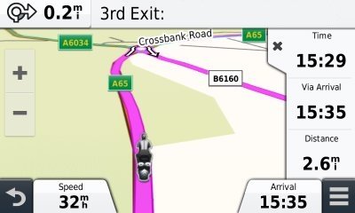

You mean like this ?
This is a screen shot from the XT. The 595 has a spanner icon in the bottom right corner.
Yes - Main Screen -> View Map -> Spanner menu -> Trip Data ***
You can select 3 items from that set of 8 that are shown . Each one overlays the last so that you cannot see it the one before. But when you press the cross, to close the last one down, the one before it comes back into view.
*** Trip Data may not appear in the display of 8 icons. Others are available, and you can configure which 8 you have instant access to.
Main Screen -> Map & Vehicle -> Map Tools -> select the tools you want
Once Trip Data is shown down the right hand side - like int he picture, You can configure the 4 items down the right hand side to show what you want. (The 3 new ones and the one next to the spanner)
Tap any one of them to show the list of available entries. Some may not be available - eg Time to Via is only available if you are navigating a route.
The ticks show what is already on the screen - so you cannot choose them again.
The menu remembers the settings for when you are navigating, and when you are not - so when you stop navigating the items in the right hand bar will change back to what was there when you set it up before a route was being followed.
