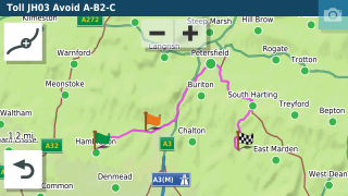

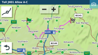

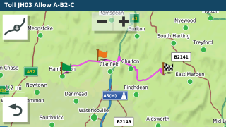

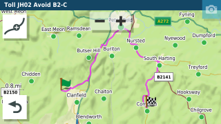

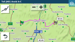

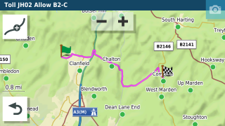

Not quite.
If you set the XT to avoid toll roads, A-C works. The other two tests take a sweep north to Petersfield
If you set the XT to allow toll roads, A-C takes a sweep SE first, then NE. The other two work.
Avoid Tolls Set
Allow Tolls Set
Im sure the tolls thing is a red herring. I'm wondering about the affect of the presence of B2 in the route. But so far, I cannot see a clear pattern
Avoid Tolls Set
Allow Tolls Set
