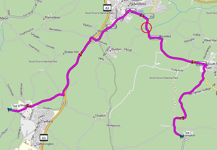

Here is the message I sent to Garmin, I have attached the image ( cant figure out how to insert inline) and the GPX file so you can try this, I am using the updated Garmin Map, I do not think its a map error because the when I calculate A to C it works correctly
I am trying to figure out why in loads of occasions the my Garmin XT routes me through town centres, and routes that seem very odd, and is very annoying.

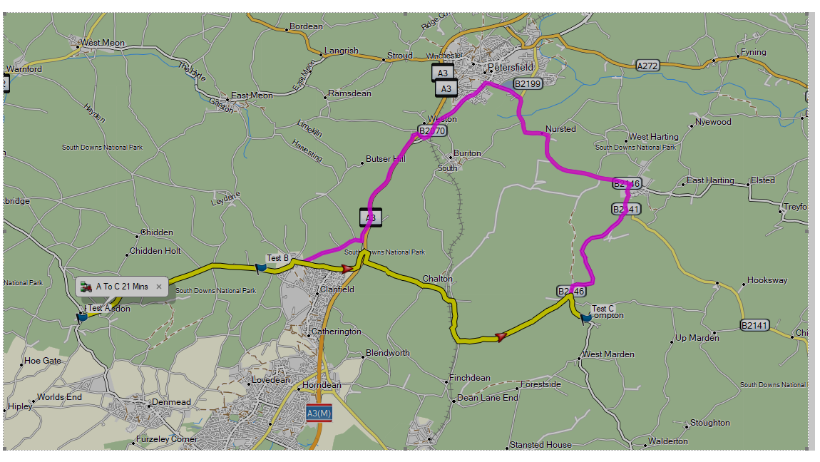

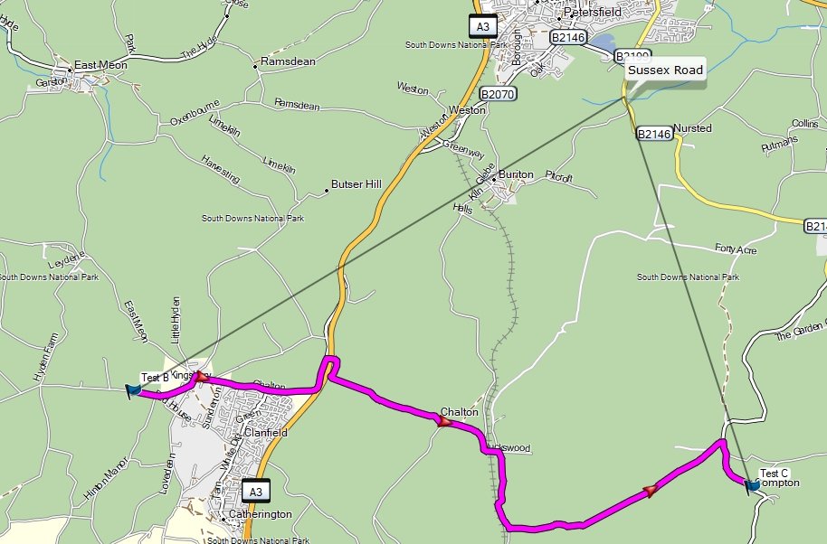

I have setup some tests, I have 3 way points , A,B and C . All these tests are done with no adventurous routing, and no avoidances and routing option set to the fastest time.
Tests (See image below for visual representation)
1. When I create a route from A to C it creates a route as expected. This route takes 21 mins (Yellow route below)
2. When I add a way point B that is on the route, the route changes to go north through Petersfield and the route takes 28 mins (Magenta Route )
3. When I create the route from B to C it follows the route in test 2.
I have attached all the data you need to test this. Please could you help me figure out why ?

Scott has 3 routes A to C, B to C and A to C Via B.
Only the A to C takes the shortest, fastest route. The other two, both of which involve Point B, take a large loop to the North.

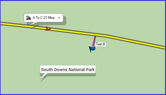

Use Basecamp to Zoom in on Point B to reveal the issue.
Point B is not located on a road. Move point B onto the road and the problem goes away. So does recalculating the route.

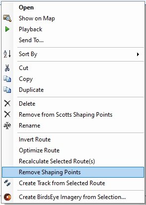

The correct way of deleting a point is to remove it from the route list. Selecting Remove Shaping Points removes shaping points but leaves the route where it is. The method above is not a programming error - it is deliberately designed by Garmin to get rid of unwanted shaping points without affecting the route. The route is still transferred correctly to the Zumo, and the Zumo will follow it. Until it recalculates !
It is very useful for finding out which sections of a route are recalculated in different situations when riding. I use it for testing purposes.
