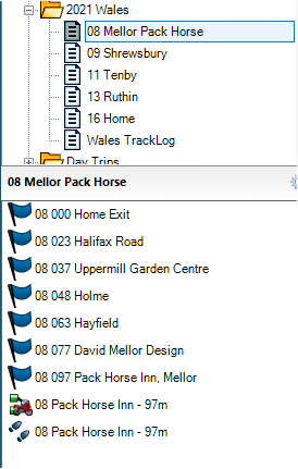

I assume that you mean something like this in Basecamp
In the above Example, 2021 Wales is a List Folder.
08 Mellor Pack Horse, 09 Shrewsbury, 11 Tenby etc are lists which contain the routes, waypoints and tracks for a single day.
The botttom windo shows the waypoints, the route and a track for Day 08. I have put a number at the front to make it easier for me to recognise to which day a particular route, track or waypoint belongs.
I can send 2021 Wales to the Zumo - but the process strips out the folders names and the lists. That is something to help keep everything organised when it is in BAsecamp. The Zumo is only concerned with the names of the routes, tracks and waypoints.
So Double click on the route. It will show a dialogue box in which you can change the name. Or you can change the name in the window pane shown above. Click on it once. Wait a second and click on it again, and it will allow you to edit it.
Ditto with the Waypoints names and track names.
(I add the mileage to the waypoint names once the route is finsihed - which I find useful when using the satnav - so 08 063 Hayfield was 63 miles from the start of the route on the 8th day. AMongst other things, It keeps all of the waypoints sorted in order, which can be very convenient.)
