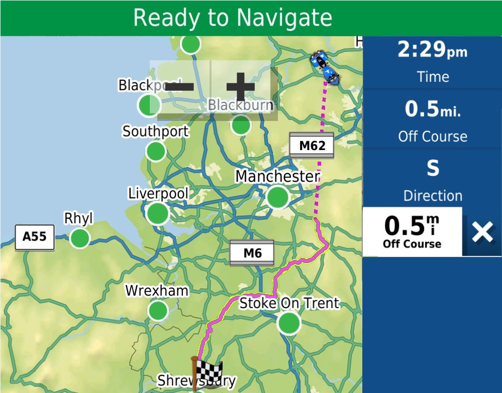

I took a look at your track and thought - 'why is the straight bit dotted' ? So I converted a normal road route into a track on Basecamp, sent that to Zumo and imported it. Excuse my thinking out loud in this post - much of this is stuff I hadn't come across before.
First of all, the ability to turn on or off an individual track is there on mine (v6.10) Select the track, the map shows up with a spanner in top left corner (landscape mode). Click the spanner and a 7-item menu pops up. Show on Map is the 5th item below Share, Name, Set Colour, Track Width. A single tick box, which turns on the single track.
What I had not realised was that having selected a track, you can press 'Go' and the Zumo XT plots the track and looks as though you are navigating a route. Turn on the Trip Data display and it shows how far off course you are. I too get the dotted straight line display. It joins where I am now to the start of the track. Excuse the image below - it is cobbled together from two different screen shots - to show the blue data display on the right. You can tell it is a 'mockup' - it shows me as being 0.5 miles off course. I'm actually about 30 miles from the start of the track. I could not get it to zoom out to show the entire track and keep the data display on the screen.
The magenta line is the track being navigated, including the straight line route to get to the start. The yellow halo effect is the original track - made visible and set to its widest - the only way that I could make it show up underneath the magenta line. It appears where the magenta line is solid. You may need to click on the image to get a better view.
There was no long delay in calculating the magenta line. The startpoint was the nearest point. I wonder if in your case the twisty turny nature of you track it was trying to find the best place to join ??
This is all new to me - I've been looking at the behaviour of other aspects. Was this feature to display a track as a navigable magenta line there before 6.10 ?
As for needing to reset it - if its not doing what you expect, then its not a bad idea, and its one of the first things tech support ask if you have done. But you will lose your archived trip logs - so copy the 'Archive' folder from the GPX folder and the CurrentTrackLog.gpx from the GPX folder if where you have been is important to you.

Right.
You are 'navigating' a track. Tracks don't behave the same way as routes.
Routes use the navigational powers of the Zumo to calculate a way the road network to get you from one fixed routing point to the next. On the way it can detect if you have wandered away from the route, and if you have it can plot a different way to get to the next point. If you allow it to make such calculations. If you don't allow it, then it goes quiet and leaves you to sort your own way back to the route. As soon as you join the route it starts to talk to you again. If your route starts 10 miles up the road from where your bike is parked, the satnav will plot a way to get you to the start point and as soon as you get there it will follow the route.
But you have loaded a track, and have selected 'Go'. This was the bit that was new to me. I didn't realise that they had made this possible. A track is a series of very short straight lines joined together to closely follow a track or trail. The Zumo cannot 'navigate' you along your track - there are no roads or plotted routes in the map (not that it is using anyway). It is simply drawing the track on top of the Zumo map and you are following it.
A few of us often superimpose a drawn track onto the map when we follow a route, so that it makes it easy to see when the Zumo has deviated from the original route.
But this situation is slightly different. The zumo has plotted a magenta line, it is following the original track, but it is not doing any calculations. You can put the Trip data at the side of the screen and ask it to show 'Off Course' data, which will indicate how far away you have wandered from the intended track. It will also indicate where the end is and give you an ETA and a distance countdown. And it will show your speed. But there are no spoken words, no turn directions and no recalculations.
You can achieve the same effect by creating your own route of short (or long) straight lines, set the routing preferences to off-road (which from v6.10 is relabelled 'straight line' on the Zumo set of preferences), and turn recalculation off.
Alternatively, you can load in a track from explore, and get the Zumo to convert it to a trip. (There is an option after selecting a trip from the Explore App on the Zumo).
This gives you a warning that if you try to edit the route or the routing properties or preferences, the trip will be discarded and a new one will be calcluated.
So - your off road route which sets off some way from where you are has a problem. The route that is loaded has come from a track which is a series of short straight lines which do not 'navigate' on any roads - ie the Zumo isn't following roads. It is following a line that it has been told to follow regardless of the map that it is plotted on. It has been set to not recalculate, and there are no routing preferences that it need worry about.
And because of that - it cannot plot a route from where you are to the start of the track. All of those features have been turned off. Any attempt to get it to navigate that first bit - the dotted straight line - will mean turning those features back on - and that means that it will attempt to calcualte a route using roads that it knows, not the track or trail that you want to follow, which will then be lost - which matches what you have found out.
This makes perfect sense to me. I think if you want to get to the beginning of your plotted track, you will need to make a route from here to there. When you get there, stop the route and load the track.

For comparison, my tomtom will route me to the closest part of the track, and continue routing the rest of it, making changes as needed to keep on the track. It works tons better, for sure.
I bought the xt for the live weather, it probably was a mistake. One bike more than on occasion add the tomtom mount on the 2nd ram ball.
I'll play with it more since Myrouteapp.com does via and shaping points now. I'll also play more with converting to trip
Already found a work around for all the tracks being displayed, I can select ones to be displayed like before.
