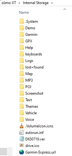

Internal Storage
The Root Folder.
The image shows the main subfolder names. .System isn't always visible - you have to make it visible if you want to see it. But that is a separate thing from what you want to know at present. It is normally hidden becasue it contains the system folders which generally speaking could prevent your Zumo from working if they are messed around with.
The two folders of interest to us at the moment are Garmin and GPX. I have images with examples in the next two sections.
You might also notice a folder called MP3. That isn't there by default, you have to create it if you want mp3 files to be stored in Internal Storage. In fact, I don't - I put it there to test something out and forgot to delete it ! But if you want music files there, that is where you need to put it. On the XT it doesn't matter whether you call it MP3 or mp3 - but on some Zumos it has to be in upper case.

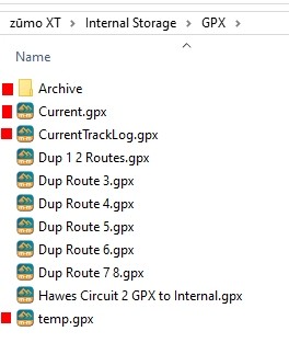

Root Folder / GPX
This shows the content of my GPX subfolder. It may or not be there already. If you transfer data from Basecamp, the system will put it there. If you create a route using trip planner on the Zumo, it will put the GPX folder there. Otherwise you have to create the folder yourself. It has to be galled GPX (capital letters are what I have always used, so I do not know if gpx in lowercase works.)
The 4 entries that have a red box next to them are put there by the system. The others are GPX files that I have placed in there. These are some test routes that I created to test XT behaviour. Each of them contains routes, saved waypoints/favourites and tracks.
CurrentTrackLog.gpx
...is a record of your recent riding activity - stored as tracks which record where you have been, the date, time and speed at locations that are plotted anywhere between 1 and 20 seconds apart - depending on how straight the road is. This can be really useful if you like to keep these as a record of where you have been and when. I do.

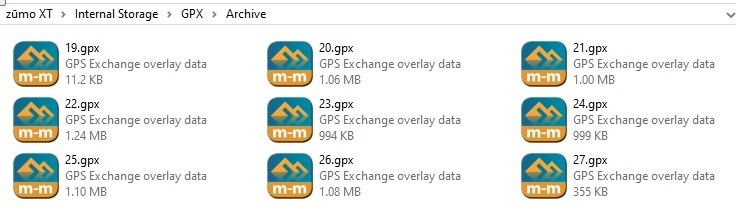

Archive
This is created automatically by the system and will appear only after you have ridden a few days with your Zumo. When the CurrentTackLog.gpx file becomes full, the Zumo will take some of the older tracks and save them as a numbered file in the Archive Folder. Starting at 1.gpx. When 1.gpx gets to be about 1MB, it will start a new file called 2.gpx and so on. Every few months I will copy all of the files in Archive to my hard drive - overwriting any that I have previously downloaded. This is because the XT keeps updating some of the archive files in an attempt to keep complete tracklogs together. That way I am sure to get the last version of the file on my system.
The third image shows the contents of my Archive folder. Typically it would keep the last 20 files, but for whatever reason it has got only the archives from 19 to 27 - ie the last 9. I don't know why that is. The m-m icon that is associated with the gpx files is to do with my computer. Typically I open GPX files with a program called Memory-Map, because I like to see my routes on a properly drawn high resolution Ordnance Survey map - the sort that is used by hikers and emergency services.
Current.gpx
This is a file that contains all of the routes, tracks and saved location / Favourites that are currently available from the Zumo screen.
temp.gpx
Is a file that is used by Basecamp to temporarily store data (routes, tracks and Waypoints/Favourites) that has been transferred from Basecamp.
This file will be overwritten by subsequent transfers. Tracks are deleted from the file once they have been imported. Once imported it must be assumed that you may not be able to import them again - if say you deleted a route from the XT.

Internal Storage
The Root Folder.
Root Folder / GPX
CurrentTrackLog.gpx
Archive
Current.gpx
temp.gpx
