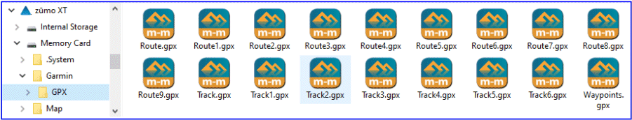

If the same operation is carried out but data is sent to the Memory Card instead of to Internal Storage, then each Trip saved as a separate gpx file in the Garmin / GPX folder. As in the image below:
When transferred to the XT from Basecamp, Waypoints are saved in a single
file called Waypoints.gpx.
