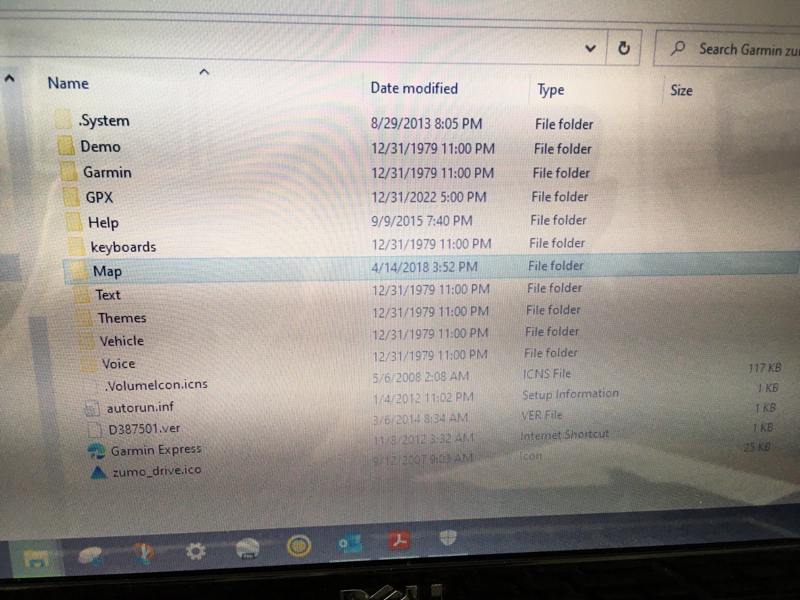

This is a screenshot of what is in the Garmin unit.
I haven’t moved or deleted anything yet.
I’m going to move the entire “Map” folder to the sd card. Before I move it, I’m going to make a folder in the sd card named “Garmin”.
That’s where I’ll drag and drop the ‘Map’ folder, correct?
Also, to free up more space, go into the “.System” folder and simply delete the “SID” folder, the “JVC” folder, the EULA folder?
Please confirm. I’m scared. Lol

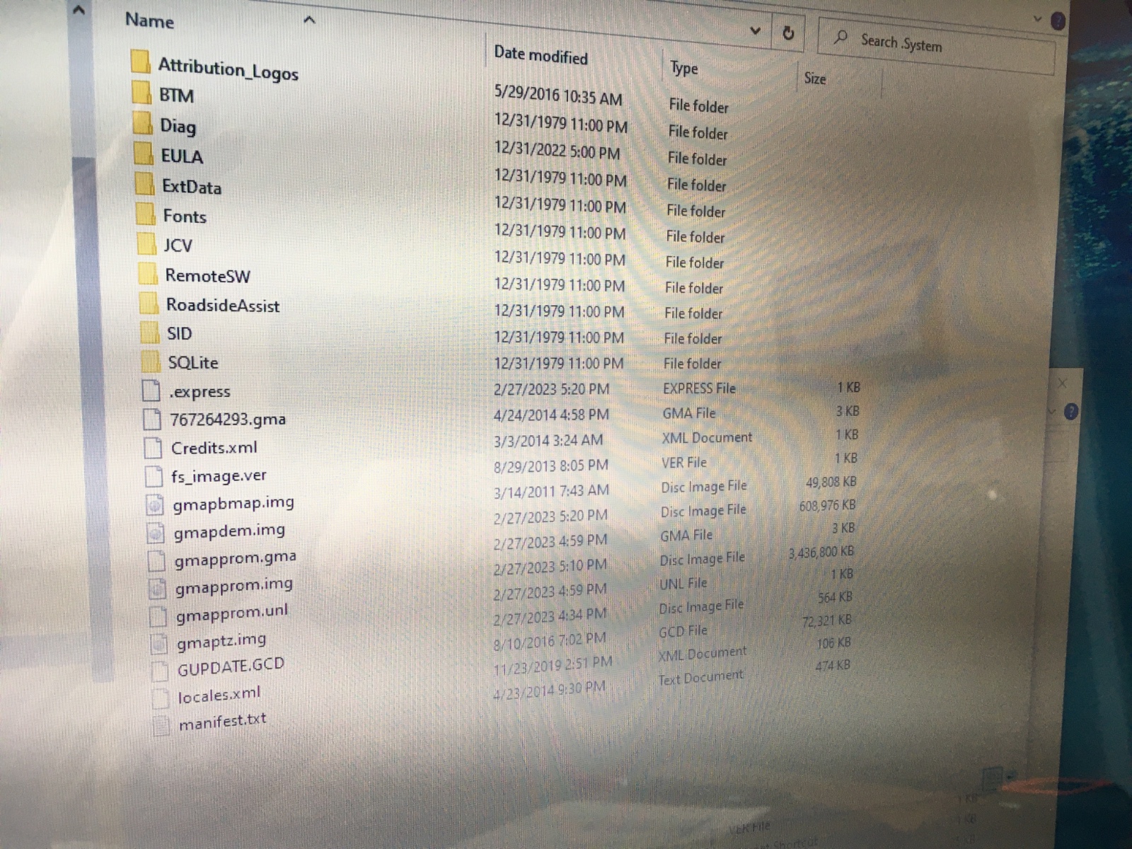

Iris
Posts: 92
Been liked: 17 times
Re: Identical Maps?? Garmin Zumo 595LM 95% Full!
Post by Iris »
Here’s what my system file looks like.
What else can I delete?
What else should I move to the sd card?
