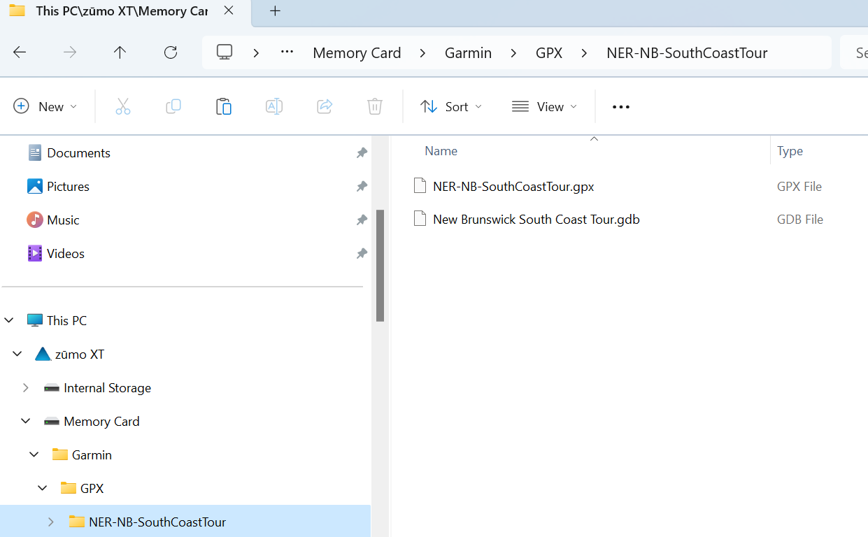

but what's odd is I have another gdb file on the SD Card for another route in New Brunswick, went thru original steps, copied it to the Card, used Trip Planner Import and it works fine, and that file is a gdb file, ok wait, hang on, i'll check the XT to make sure...
Ok back, that gdb file New Brunswick South Tour was in Trip Planner, I selected it for Import, started the route and it works just fine. but the Meteghan Backroads Route file won't work now as a gdb, only as a gpx. I am puzzled. But I'm still going to scrap my idea to save all my routes as gdb and save them as gpx.

this imported New Brunswick South Coast Tour.gdb file on the SD card works just fine after imported on the XT

Re: How to transfer waypoints to SD card on XT
Yes, but you have a gpx file on there as well, and that has almost the same name, so I am guessing that it contains the same data as the gpx file ?
Unless you know for certain which unique tracks, routes and waypoints are stored in each file, you cannot say where the tracks, routes and waypoints are being obtained from. I suspect if you delete the gpx file, the Zumo wont find the routes etc ???
This is often a problem with data on the sd card, and internal memory. The Zumo keeps finding things that you think you have cleared.
I have also seen the zumo find gpx files which are not saved in the usual places. I suspect that on some devices you can put them anywhere. But I hardly ever mention that, because I don't know whether or not it is true for all Zumos. I tend to stick to the locations that Basecamp uses. But I note that you have discovered that you can use a subfolder on the XT.
