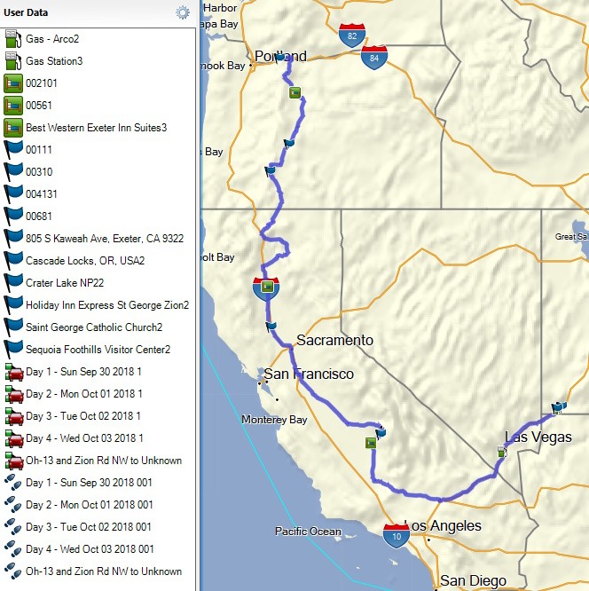

I break down my multi-day tours into single-day routes on the SDcard. I usually just delete ALL the User Data on the card when I get home. Not tedious at all! With rare exceptions, I already have all that info in my Basecamp database, where it came from. But it should not be terribly hard to deal with individual items on the card.
Here is my SDcard, with four days of routes from a past auto trip, and another local route in Ohio, with their associated tracks and waypoints.
(I'm using the North American DEM map from the XT, sometimes a lack of detail makes things clearer.)

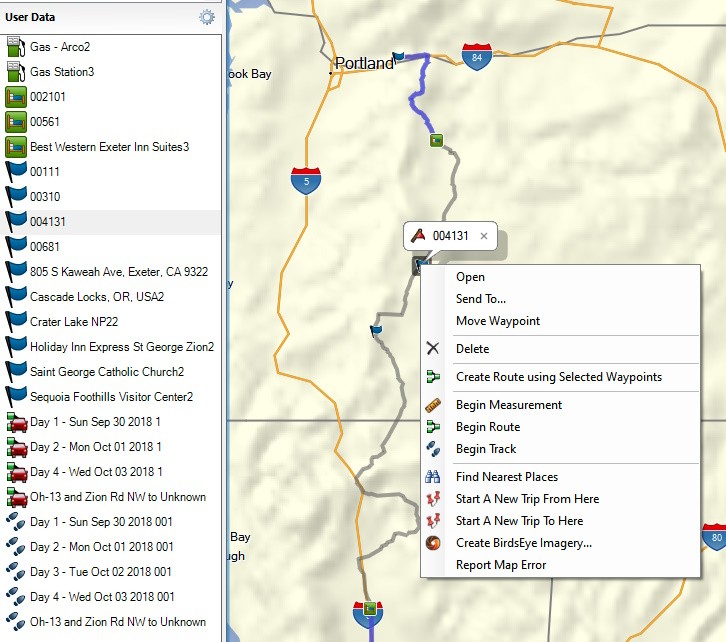

As you said, identifying a single route or track for deletion from the card is easy, just click on the name and it will be highlighted on the map. Or, click the route and the name will pop up.
It is a little harder to sort out which waypoints go with which route, but if I've deleted the route, the left over waypoints stand out alone (or along the track). Right-click on the symbol to delete the point. Here I've deleted the Day 3 route before removing two intermediate waypoints:
