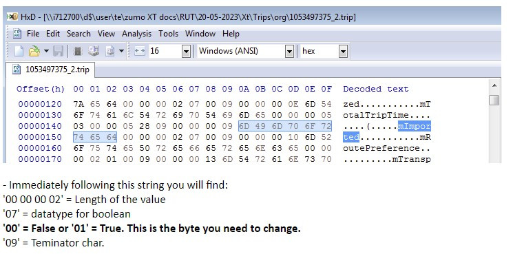

How to I access the location for the trip files in the Zumo XT ? I cant see the folder, even viewing hidden files on the PC ?FrankB wrote: Fri May 19, 2023 1:09 pmI suspect also transferring / importing.jfheath wrote: Fri May 19, 2023 10:35 am I have been thinking that it is a Basecamp issue - or an issue when transferring / importing. The latter is more likely as we know.....
All trips that you find in the trip planner, be it saved, or imported, are stored in "zūmo XT\Internal Storage\.System\Trips". Filenames have extension .trip.
When a Route/GPX is imported from Basecamp, or whatever source, it has to be converted to this .trip format. This is a binary format, so not easily human readible.
If we could pinpoint the difference between a saved trip on the XT, and an imported trip from Basecamp, that would be interesting. Alas I have not found documentation of the trip format.
Hex dump of a portion of a trip file.

Second, for those who are reluctant to install Java on their computer (security concerns), I found a very good multi-platform online hex editor. I just used it to successfully convert an existing Imported Trip to a Saved Trip. For Mac users, here is a brief outline of the steps:
1. Activate access to the hidden System files on the XT.
2. connect XT to your Mac via USB.
3. Launch Android File Transfer app (you may have to click OK more than once and wait a few seconds for it to see the XT).
4. Copy your trip file(s) to the desktop.
5. Go to https://hexed.it/ and open a trip file.
6. Change the entry at "mImported" from a 01 to a 00 and export the file back to your Mac desktop.
7. In Android File Transfer, copy it back to the XT, replacing the old trip file.

A screenshot showing which byte to change.danham wrote: Mon May 22, 2023 3:22 pm 6. Change the entry at "mImported" from a 01 to a 00 and export the file back to your Mac desktop.
