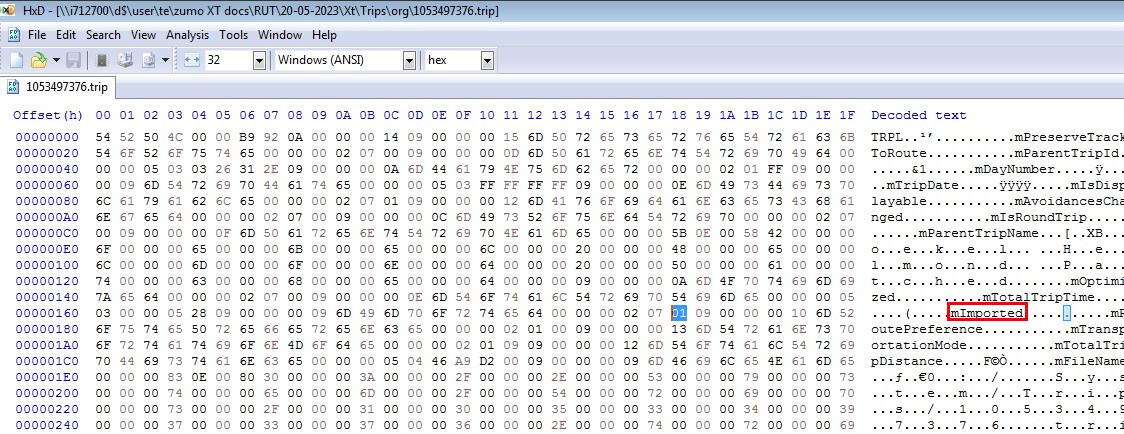

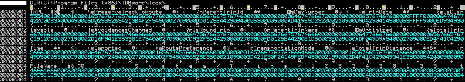

I suspect also transferring / importing.
All trips that you find in the trip planner, be it saved, or imported, are stored in "zūmo XT\Internal Storage\.System\Trips". Filenames have extension .trip.
When a Route/GPX is imported from Basecamp, or whatever source, it has to be converted to this .trip format. This is a binary format, so not easily human readible.
If we could pinpoint the difference between a saved trip on the XT, and an imported trip from Basecamp, that would be interesting. Alas I have not found documentation of the trip format.
Hex dump of a portion of a trip file.

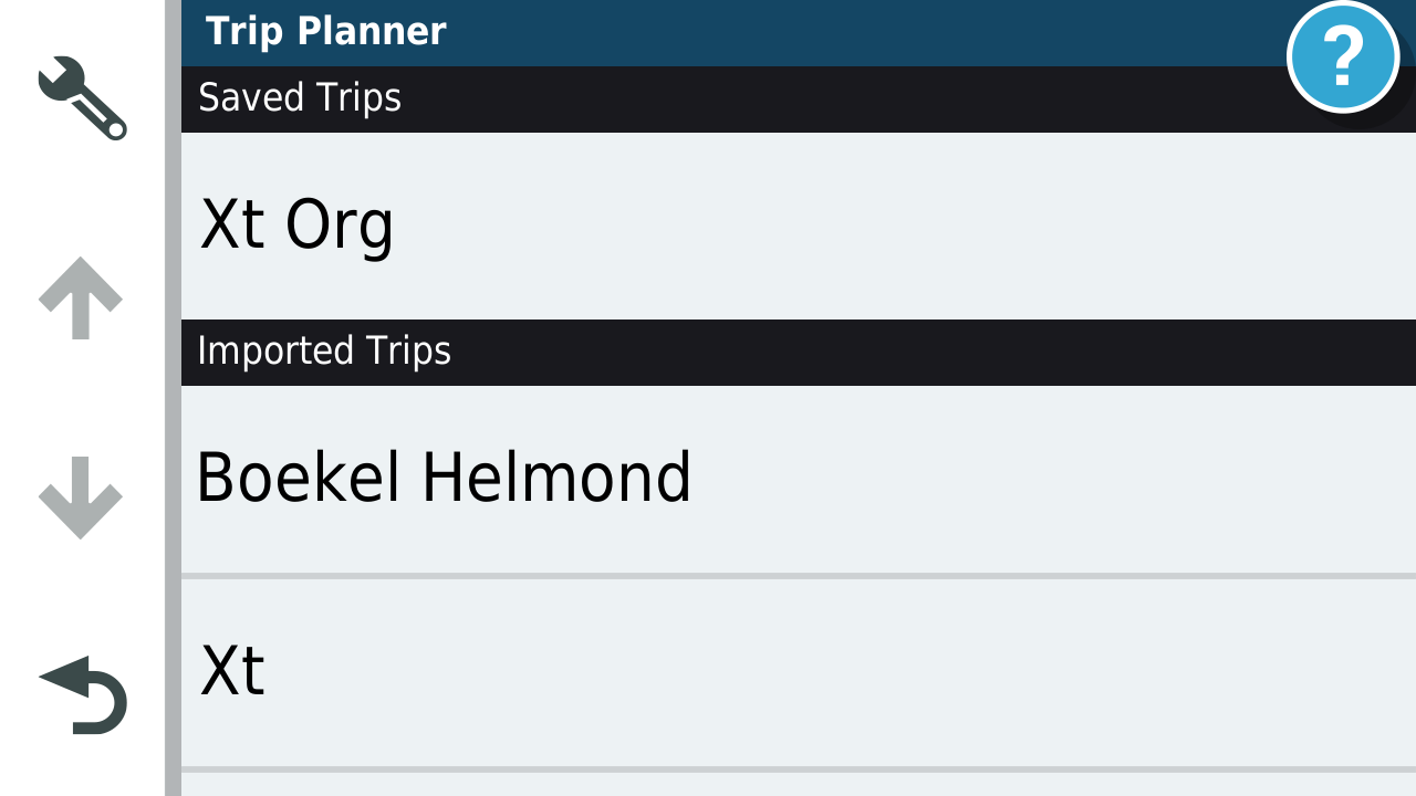

Re: Weird Routing Behaviour - Success.
On the XT Trip planner trips can be under 'Saved', or 'Imported'.
I have to test it, but I strongly believe that 'Saved' trips have no RUT, and 'Imported' Trip do have RUT. By looking at the the .trip files with a hex editor I found a flag named 'mImported'. It corresponds with trips 'Saved'/'Imported' in the trip planner. Could that be the flag we have been looking for?

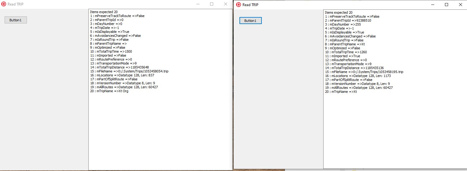

This is screenshot of a quick & dirty program I made to display the various info in the .trip files:

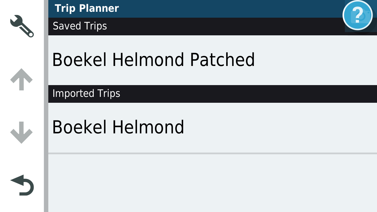

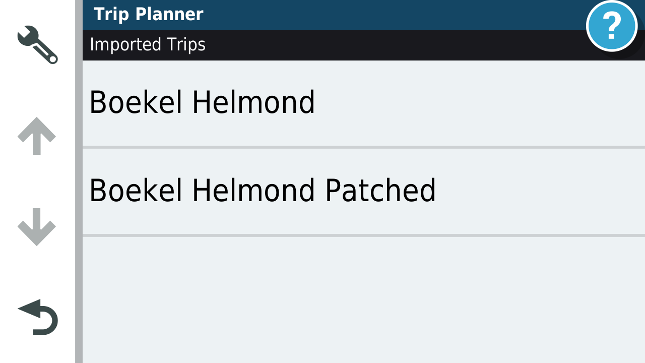

Very promising finding
This morning I did the following test.
- I opened a route in Basecamp that I was sure to get me in a RUT.
- I duplicated this route and renamed it to 'original name' patched.
- I then had 2 identical routes that I both sent to the XT.
- Once imported on the XT they were both under 'Imported trips' - I then copied the .trip files from the XT '.System\Trips' to my hard drive.
- Using a Hex Editor I changed the trip named 'patched'. I changed the byte that defines wether it's an Imported or a Saved trip. - Copied the files back to the XT in the same folder. (Overwrite)
- After rebooting the XT the Patched trip was listed under 'Saved trips'. (That proved that I modified the correct field) - After that I actually drove the trip. And guess what? It behaved perfectly
