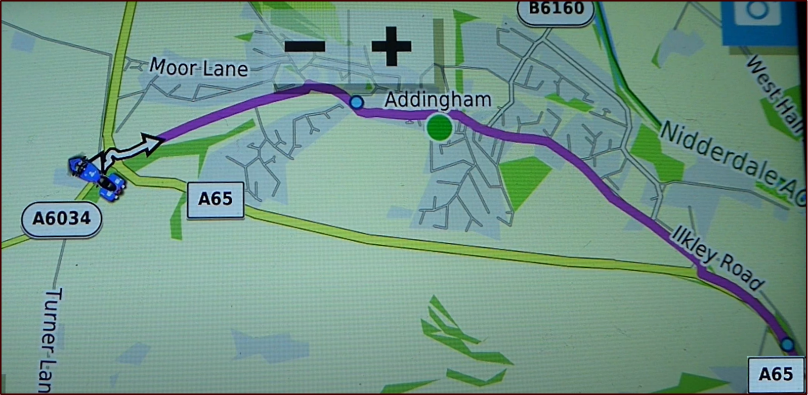

Take a look at this screen shot.
Ignore Route Screen Shot.png (1.85 MiB) Viewed 2258 times
This screen shot of part of a route applies to both of the following videos. I am on a side road just before the roundabout. I have loaded a route and I am following it, having previously skipped a route point that I had placed close to the start (so that I could skip it !). I ulled over to get some the above screen shot.
It shows me stopped on a side road immediately ahed of the roundabout. Note that when I am not moving, the satnav doesn't know which way I am facing !! I am actually facing South - but I was facing that way a few seconds before I stopped moving.
The planned route is shown by the magenta line. There is a Shaping Point on the magenta line after the roundabout and before the village of Addingham. I need to take the second exit to go through that Shaping Point. The third exit at the roundabout is the A65 (we go around rouandabouts clockwise in the UK) - a fast 60mph road which by-passes Addingham. It joins up with the magenta route in the bottom right hand corner of the screen shot - and there is a shaping point just after that - so I pass through that shaping point whichever route I take.
Both videos show what happens when I take the 3rd exit (A65) road at the roundabout instead of following the route to the 2nd exit.
The only difference in the videos is the the first one shows what I regard as 'correct' behaviour. What the Zumo 590 would have done. It has been created using the Zumo Trip Planner using stored Waypoints (from Zumos Favourites). The Zumo regards this as a 'Saved' route.
The second video shows a route that uses the same waypoints. Not copies. The same ones. The route has been create din Basecamp, transferred to the Zumo XT and then Imported. The Zumo XT regards this as an "Imported Route". I drive the same route doing the same things in both videos.

Pressing Skip (or otherwise causing an imported route to be recalculated) causes the navigation system to behave differently.
I am wondering if onthe XT2, multiple refusals to follow instructions also change the nature of the route in a similar manner.
