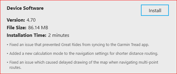

Re: XT2 turns off and restarts
I have v4.70 - no problems.
Clean the screen thoroughly. Check the battery is Ok.
I wonder if the software would reinstall ?
If you think that the software 4.70 is the culprit, you can go back to the previous version (4.50)
Make sure that you have plenty of power in the battery. I do not know what will happen if the battery runs out part way through this process.
You might want to talk to Garmin Tech Support first. I am going to check out theat these instructions work before I post in on the forum.
But you do this at your own risk.
At any time if you want to abort, just leave it doing nothing for 30 seconds.
A very similar operation is decribed here for the Zumo XT1. The process is the same but the menus that pop up are different.
https://www.zumouserforums.co.uk/app.php/ZXT-P85
This will give you an idea of what the screens look like when you do this.
I have just checked this procedure with my Zumo XT2 and it has reloaded version 4.50. See if the problem remains.
Then you can update the software again using Express. Maybe the last instalation failed for some reason.
Note that all settings and all data are lost in this process.
Ok - I'm going to reinstall 4.70 now. I'll check that works before I post this message. Yes it does.
