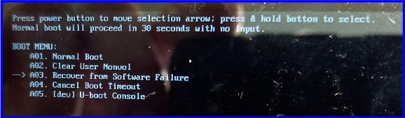

- A rather dim screen appears. Use the power button to cycle through the menu.
- Select A03 Recover from Software Failure
- Press and hold the power button until the menu changes to this one - I made this facsimile of it as it is extremely awkward trying to get a decent photograph of the dim screen with the reflections.
Option B02 - To install the software from the memory card
Option B03 - To reinstate the previous version of the software. You don’t need the copy on the memory card. Select Roll Back Software.
- In either case, hold in the power button until things start to happen.
- Update process starts - takes less than 5 minutes
- The device starts automatically and greets you with the software selection.
B03 Rollback worked fine for me.
B02 install from the SD card I had no success with although the process seemed to work fine.
(But I had to rename the file from B348400.update.signed - which may have been the issue.
