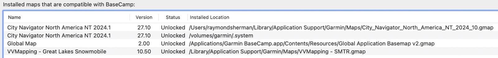

If you have your Zumo attached by USB and you open basecamp, when you click on the maps that are listed as being on the Zumo, it will tell you which file that map is using.
This helps a bit, but when I tried it - it didn't account for all of the files. (But BC doesn't show FourSquare or the DEM - digital eleveation map). But it might help to identify unwanted previous versions of maps.

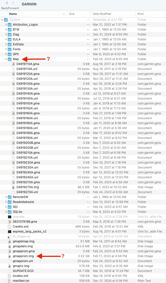

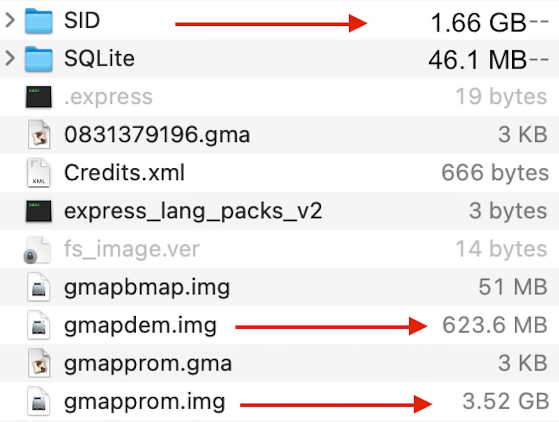

I took some current snapshots of installed maps in BC and the 595LM below. BC doesn't show FourSquare or DEM on my MacBook Pro as well. As you can see only one shows in Garmins .System folder in BC. Everything in BC looks to be correct at this point. I don't know what and/or how but, the duplicates are now gone. VVmaping is for snowmobile trails which is not installed on the 595LM.
I'll go back into the .System folder and delete what you mentioned. If I have any concerns and /or unsure of anything, I'll ask you for further instruction. As I mentioned before, I did back up the .System folder at the very beginning. The biggest files I see in the .System folder are shown below as well but, my guess is that those have to remain due to being the installed maps. It would be nice to be able to aim those at my SD card. Thank againg to both of you for all your help!! I couldn't be at the point I'm at without it!

Re: Identical Maps?? Garmin Zumo 595LM 95% Full!
Gmapprom.img is one half of your map, the other half is in the Map folder, which as already explained you could move to the Garmin folder on your sd card.
Gmapdem.img is the digital elevation model. If you don't want to see anything in 3D you can remove it.
I've already explained that you can delete all the files in the SID folder except the most recent ones. These files store traffic trends and other data
Awesome... I was just getting ready to ask you if it's the Map folder or the Gmapprom.img. that I can move to the SD card. The Map folder is only 86.5MB and the Gmapprom.img is 3.52GB. You mentioned the 3GB was in the Map folder but, it's by itself. I'm unclear of which one to move to the SD card? Thanks.sussamb wrote: Wed Mar 08, 2023 2:06 pm Gmapprom.img is one half of your map, the other half is in the Map folder, which as already explained you could move to the Garmin folder on your sd card.
Ah apologies, got confused between your screenshots and @jfheath
Yes, you can move the whole of that Map folder although there isn't a lot in it. Note you can delete most of the .gma and .unl in that folder, you just need the ones that have the same name as the .img file in that folder.
Do not move gmapprom.img
