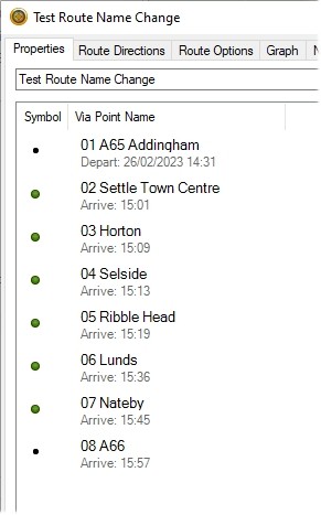

Here is an example I have just used. A BC screen shot of a route. I have changed all of the names of the route points.
THe GPX file is attached. Load it into your Zumo. You will see that every name has been altered.
These were all plotted on know locations ont he BC map, so they are probably in the Zumoss database too. Nevertheless, the get changed.
(Yes they are all Via points, but it wouldn't make any difference if they were shaping points. In the link above, some of the points there were Via points, they were changed. Some of the points (Via and Shaping) were first created as Waypoints. None of those were changed.

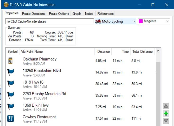

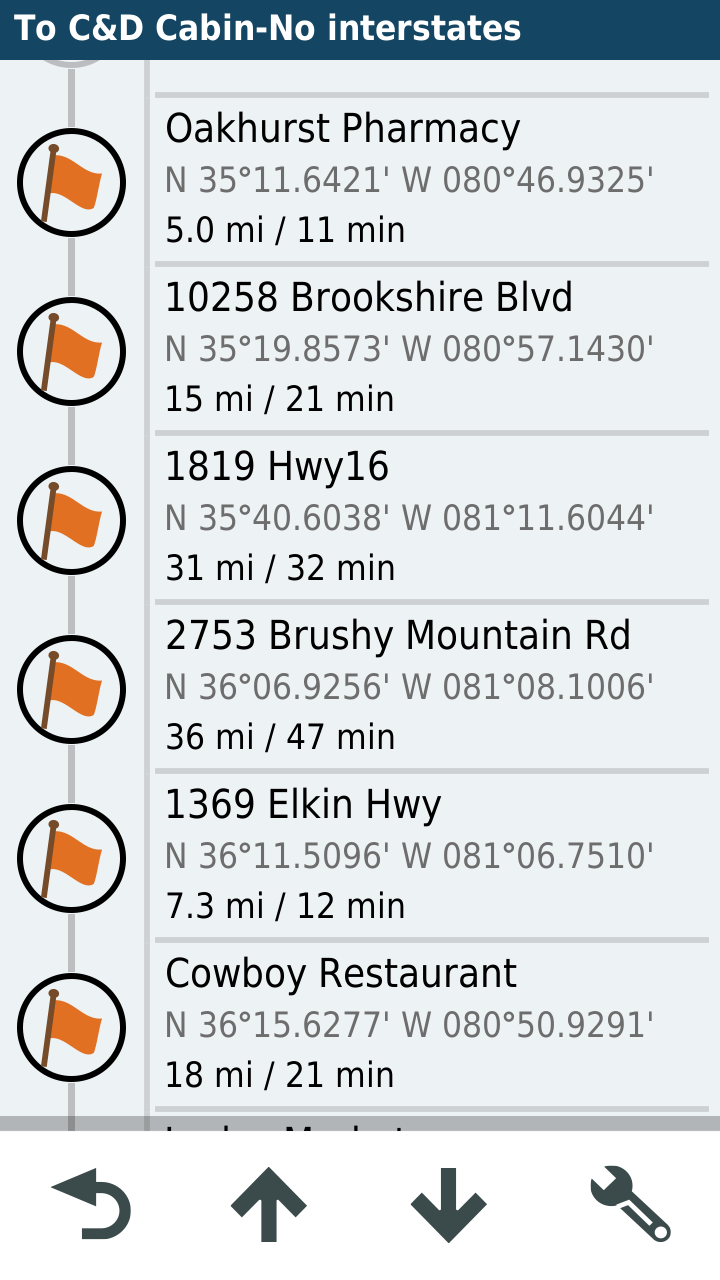

I just compared several routes on the XT with their Basecamp versions and the Via Point names are all the same, even ones with sequentially numbered Via points like your example. I transfer my routes using the "Send To" function in Basecamp (XT connected).
CD Cabin BC Via points list.JPG (69.7 KiB) Viewed 1456 times
CD Cabin XT Via points list.png (191.14 KiB) Viewed 1456 times

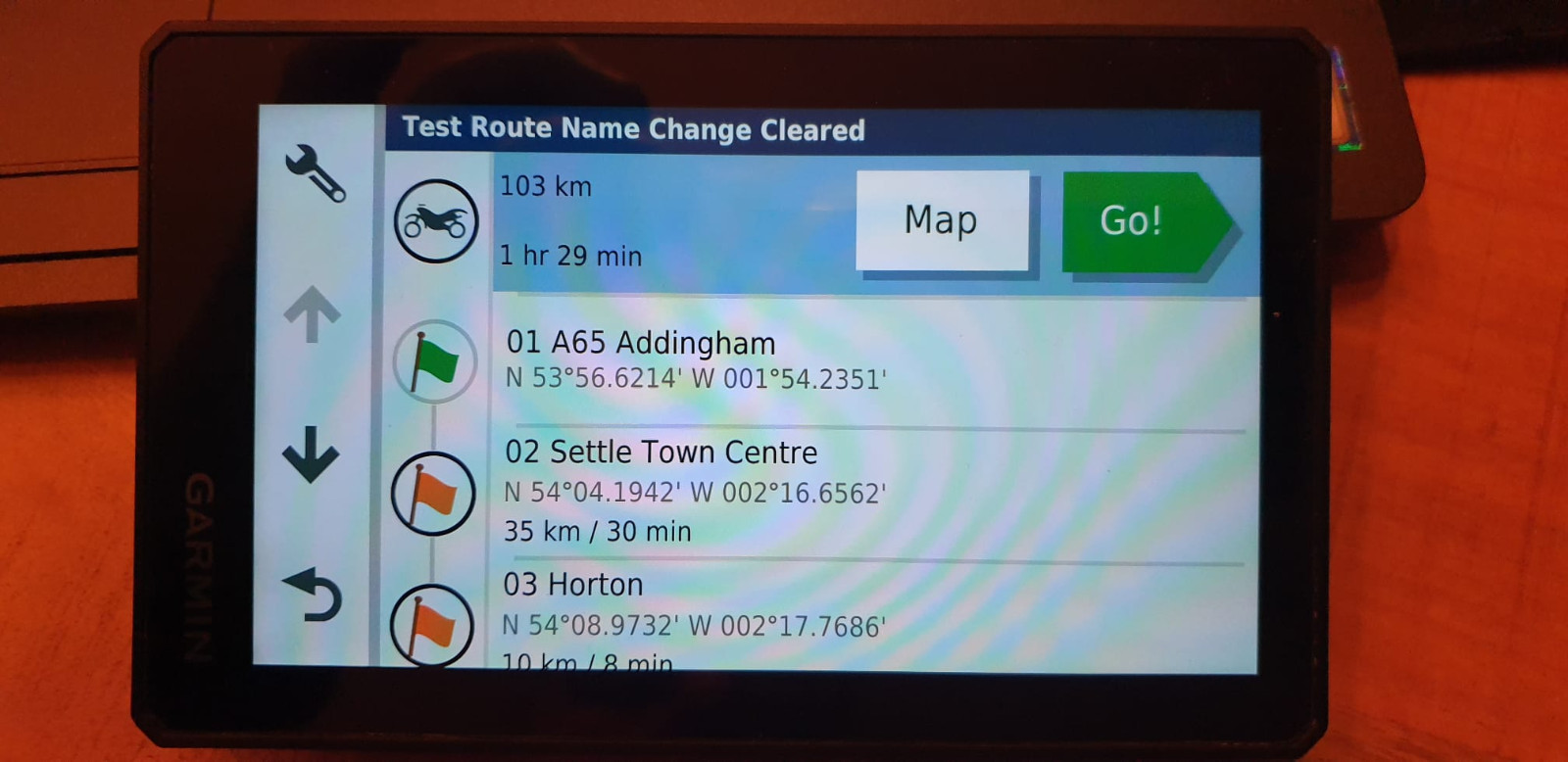

@jfheath Hi John, Have you tried clearing the subclass to '00ff'? My experience is that that stops renaming the Via/Shaping points.
See attached GPX, that has cleared subclasses. It does not rename.
Test Route Name Change_Cleared.gpx
(137.1 KiB) Downloaded 319 times
