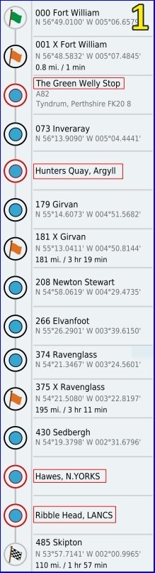

Pics 1 and 2 show a different 485 mile trip from Fort William in Scotland to Skipton in Yorkshire. The blue circles mark the Shaping Points and the orange flags mark the Via Point that I have used.
Pic 1 shows the Trip from the XT, and

This will help you to recognise individual
points from the trip list in Pic 1. But for some route points, that
number has been lost. I have outlined these points in red in the Trip
List. The XT has renamed the points - they no longer have the number that
I allocated - seemingly using the lat/long coordinates to look up a place name
from somewhere.
The behaviour seems to be random - It happens to some - but not all of the others. I don't
know why. But it never happens to points that were first created as Waypoints in Basecamp - using the Waypoint
Flag tool.

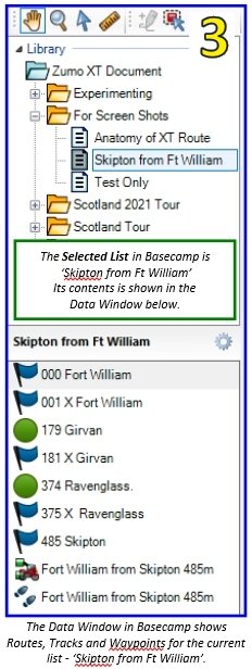

The only reliable place is to look in the bottom left pane of Basecamp. In Pic 3 I show the Library folder structure. I have a list (hi-lighted in blue) titled 'Skipton from Ft William'. That is in a folder called 'For Screen Shots' - a folder I created for preparing this article.
In the bottom pane are listed all of the items that are in the 'Skipton from Ft William' list. The Waypoints, the tracks, the routes. The routes can be spotted by the vehicle icon - in this case a motorcycle. The tracks are the pair of footprints. The waypoints are the green circles and the blue flags. But those symbols are irrelevant. I assigned them to make them stand out for this article.
If a route point appears in that bottom left
hand pane - then it is a Waypoint. No other route points appear in
there. When inserting route points, you may often land on a location that is a saved point in the Basecamp database, and you find a shopping trolley or a bank appear in that left hand pane. It is one of the many waypoints or Points of Interest that come with Basecamp.
nb - at the bottom of that pane is a set of icons (not shown) which allow
you to filter the list to show just (eg) routes, just tracks, just waypoints.
You would normally have that set to show everything.
