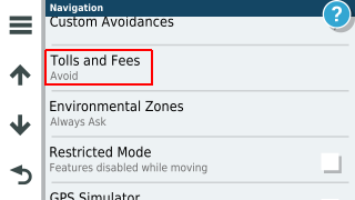

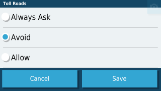

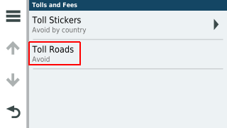

Slow Progress, but definite progress. But I have a query - something odd that I noticed.
When you set your Navigation preferences for Tolls, you see menus one after the other - like these.
I have some rather odd questions.
1) Does your XT show the current settings of Avoid or Allow underneath the caption in the places I have highlighted in red ?
ie If the current setting is Avoid, does it show 'Avoid' where I have highlighted.
2) Are your settings made for Motorcycle and Car individually. ie If you have Set 'Avoid' for Motorcycle and 'Allow' for Car, when you switch back to motorcycle mode, does it remember that you toll road preference should be 'Avoid'.
3)Is your XT set up to use link to the Explore Website? ie if you click Where To -> Explore, does it show a screen inviting to you to Cancel or Connect Now. If it does, it isn't connected to the Explore website.
4) It is possible to disconnect from Explore. So has it ever been connected to the Explore website? (At least since the last factory reset).
5) Is your XT connected to a smartphone through the Drive App on the phone ?
6) Finally - I think I am going nuts. Do your routes do different things at different times ?

Re: Routing errors (again) - any idea of a point of contact that may care ?
Some answers.
1. Yes
2. Yes it remembers different settings for car and bike
3.no
4. Never been connected
5 no
6. Not that I have noticed
Cheers
