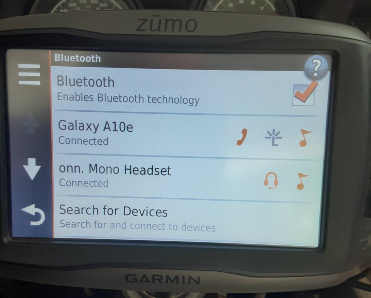

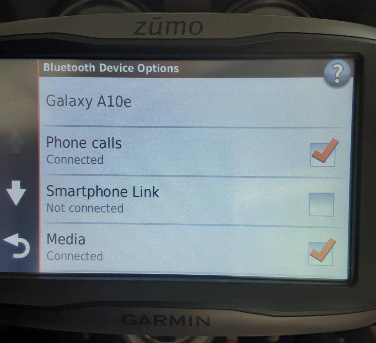

I'm including a couple of photos of settings on the Zumo 590. I am wondering if the problem with hearing the call is due to this being a MONO headset, not a stereo headset. Music comes thru the headset, key clicks come thru, and navigation comes thru.

You can upload photo's straight to the forum, in post reply scroll down and click on attachments then add filesMSTOCK27370 wrote: Tue Jul 07, 2020 8:06 pm
Sorry, I don't have a photo host service, but the link below should go to the Microsoft One Drive cloud with two photos of my Bluetooth settings.
Re: BT Connection of my Galaxy to my 590
Ok
I managed to reproduce your not able to hear a phone call problem on my setup - which is virtually identical to yours.
I tried a number of things to make it right, got it working and then undid the changes. And it still worked.
Now I can't get it to fail to repeat the exercise !!
I think it is likely to be a BT connection order issue.
Try this:
Disconnect and unpair the headset.
Disconnect and unpair the Zumo.
Turn your Samsung OFF.
Pair the headset to the Zumo. Make sure you can hear something from the Zumo coming through the headset. eg Music from the Zumo mp3 player, Key clicks, spoken navigation when you start a route.
Check the volume settings again from the main screen/volume/spanner.
When that is OK, turn off the headset. Make sure the BT connection is gone. Turn it on again and make sure the Zumo pairs and all settings are as before - without any input from you. It may take a little while, so give it chance to complete.
Turn the Samsung on.
Pair the Zumo to the Samsung.
Make sure that you get the phone icon and the music icon in the BT settings on the Zumo.
On the Samsung, check the Settings->Bluetooth
Make sure just one device is paired under the Bluetooth heading and BT slider is switched on.
Tap on 'Bluetooth'
Make sure under Zumo (or whatever you call it) - it says 'connected for calls and audio'.
Tap the gear icon
Make sure Calls, Audio and contact access sliders are all turned on.
From the Zumo, click Apps->Phone check your contacts. Make a call to your home phone. Check you can hear in headset and on phone.
From home phone, call you smartphone. Check the same.
Turn everything off.
Power up the Zumo
Power up the headset
Power up the Samsung.
Recheck.
I once read somewhere that something doesn't work unless the friendly Bluetooth name is 'zumo'. That proved to be correct at the time, but I can't remember what it was I was doing though - it might have been the smartphone link. Mine is called Zumo, (capital Z), so I started from scratch and I tried changing the friendly name to 'zumo'. I also tried installing the Smartphone Link, and gave it permissions to access the phone.
Unfortunately I did both of these at the same time. After which I started to be able to hear the sound from the phone through the headset. When I undid the changes one by one to see which change was the effective one, it still worked. So I am assuming it was the starting from scratch that was the effective operation. Certainly when I wrote that pdf document, starting from scratch with every other BT device turned off was the way to go.
Let us know how you go on. If you have no success, I'll try to make mine fail again, see what it is that causes the problem.
Try this:
Tap on 'Bluetooth'
Tap the gear icon
Power up the Zumo
Recheck.
