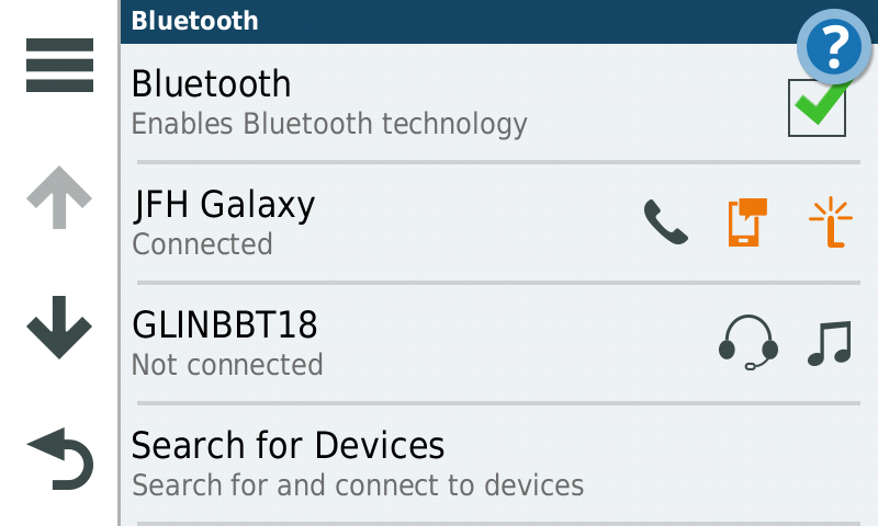

My Bluetooth Device Options showed
It took a while to get the bottom two to report correctly. Restaring the Zumo solved the Smartphone Link issue.
Allowing Notifications for the Smartphone Link on the Galaxy solved the other.

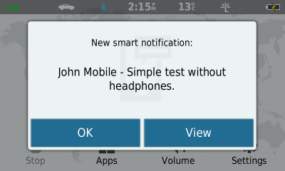

I sent a text to the Galaxy.
The Zumo popped up a screen with the some of the text and two large buttons. OK and View.
If I tapped OK, the message was dismissed.

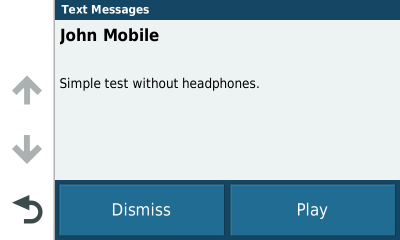

If I tapped View, the whole message was displayed and another two large buttons. Dismiss and Play.
Play read out the contents of the message on my radio - the BT device currently connected.
