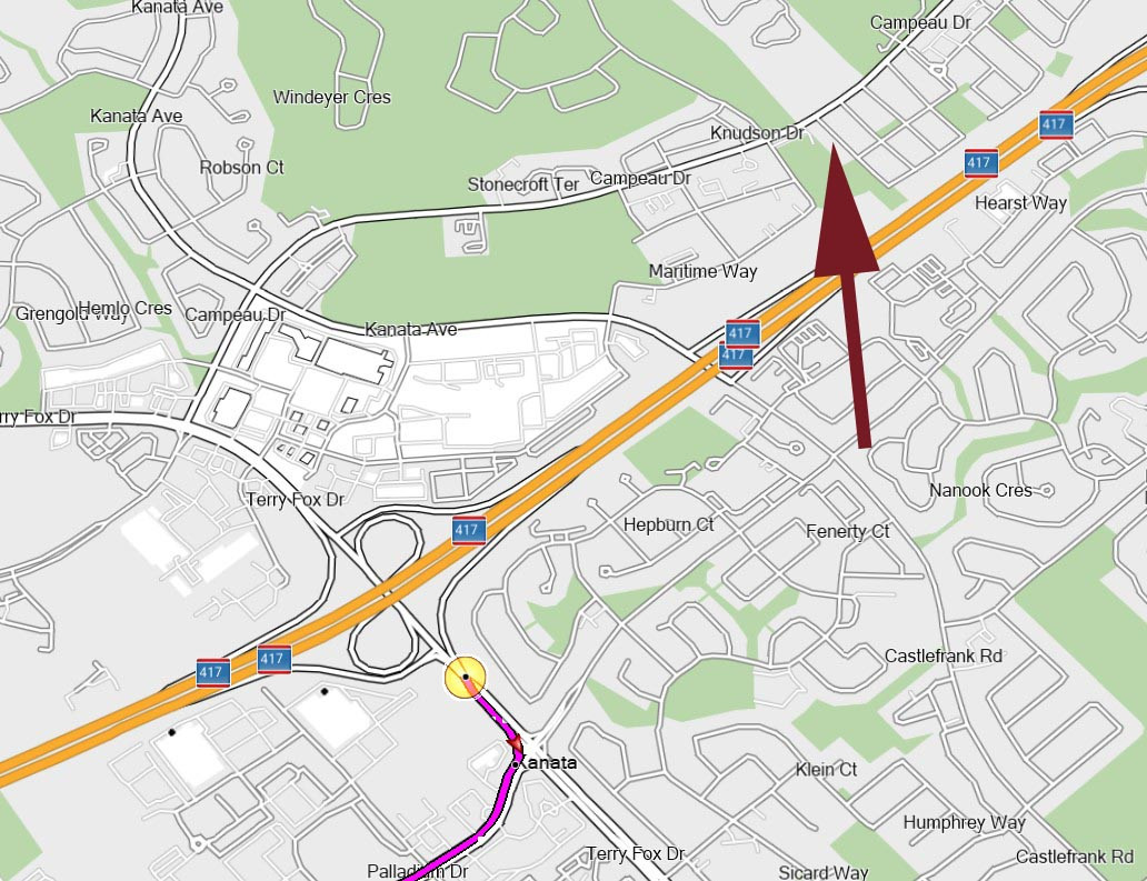

Reporting back.
Thanks in no small part to all the help that I've gotten here, I managed to complete a loop route without the unit telling me make a u-turn.
There is one strange (to me, at least) thing, though. I am attaching a screencap. The arrow is pointing to where I selected the route and told the Zuno to go and start from the nearest point. You can see the start of the route to the left and down from that point. However, the first instruction the Zumo issued was to turn right at the first corner. This would have taken me in the opposite direction from the start point. I ignored the instruction and after a couple of bad instructions, it told me to turn left onto Terry Fox Drive, which is where the start point is.
I supposed that I should have followed the instruction to see where it would have taken me. If doing that will help with any advice you can give me, I can do that tomorrow.
In the meantime, can anyone tell me why the Zumo is taking me in the wrong direction?
Thank you

I think I see an entrance ramp onto 417 at the upper right of the image. It that is indeed the case, I suspect that the XT2 was going to take you up to that access onto 417 and then down to the exit onto Terry Fox. I believe this would have been a certainty with the XT. I thought the XT2 was less exuberant about faster roads but maybe not less exuberant enough.

@Peobody You hit it. I followed the instruction to turn right onto Campeau to see where it would take me. It took me east 1 km, south 500 metres to get on the 417 highway, then west 2km. Then, it took me off the 417 to turn south on Terry Fox and finally hit the start point. I can see the "logic" of this, but in this case, the route the XT2 takes me on is neither shorter nor faster.

As a further test, I did a very short route. This time, I made the start point north of the 417 ramp on Terry Fox. (The first routes' starting point is south of the ramp.) So, the "logic" of the first route would fail since I could not pick up the start point from the ramp. I would need to turn north on Terry Fox then make a uturn to hit the start point. This being the case, I thought the unit would simply have me turn left/west on Campeau, left on Terry Fox and start the route from there - the nearest point. Not so. Instead, the unit had me take the same directions as on the first route. Turn right/east onto Campeau, right/south again in 1km, then onto the 417 to go west. It took me off at Terry Fox as before. The problem now is that I am south of the start point. No worries for the XT2. It has me turn left/south on Terry Fox, then continue to my end point. This got me to the destination, but it completely ignored the start point and the first 200metres from it to the ramp.
Clearly, I am still confused. That start point is a Via point. I thought that I had to hit them. In this case, I could have done so easily by going the direct way. Instead, the XT2 took me out of my way to the east, then south on Terry Fox, completely ignoring the start/via point. What am I missing here?

That depends on your definition of "fail". The one thing you can rely on is that it will get you to the end point, so from that viewpoint it won't fail. Beyond that, it appears that the XT2, like the XT, requires us to try to out-think it. If I had created your route I would have placed the starting point near Kanala Ave on Campeau Dr in the hopes of minimizing the options the XT2 might consider. OTOH, may folks set their starting point well away from where they'll be mounting the bike. They can load the route, choose the starting point as the entry point, then ignore the device while they go get coffee, breakfast or whatever, eventually joining the route. All is well once they do.
You mentioned that when you started the route you told the XT2 to "go and start from the nearest point". If that means "Closest entry point" then it is understandable that the start point was skipped. IIRC, I don't think the XT cares if you miss the starting point. I navigates forward just fine when you join the route somewhere between it and the next Via.
