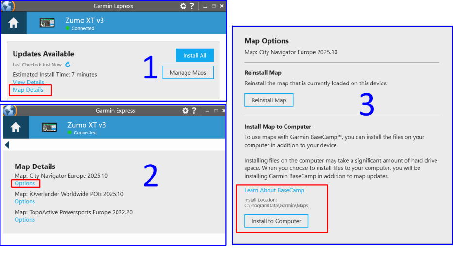

The problem with base camp is that it needs to connect to the Zumo XT to upload the maps. And it won't connect, therefore no planning possible!!

No - that isn't correct. In Garmin Express, you can install the same maps that you have on your XT to the computer.Chopperbob wrote: Wed May 22, 2024 3:57 pm The problem with base camp is that it needs to connect to the Zumo XT to upload the maps. And it won't connect, therefore no planning possible!!
Ignore 'Manage Maps' on the right. Select Map Details instead.
Don't change the location from the one it suggests.
Some time later - 2 or3 hours on my computer - it will have installed, and Basecamp will find it.
I assume that if your Zumo won't connect you will have to export the routes, tracks and waypoints that you need from Basecamp to a GPX file and put it into your SD card slot - or create a gpx file and email it to your phone and let Garmin drive put it onto the Zumo.
