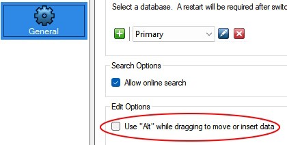

Load the gpx in Basecamp. Create a new route in that folder using Motorcycle or Driving mode. Just place the start and end points - it will be very much off course, but you will fix that. Change the new route to a color that contrasts with the old "routes". Drag the route with the "Hand" tool until it completely overlays the old track. Just grab it in the middle and drop it on the old track, then do the same with the halves on either side, and just keep putting it in the right positions. I find this easier if I do NOT need the Alt key for the move, see Edit>Options:

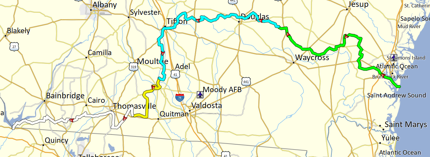

Nevertheless in Basecamp, if you have all of the routes in the same List, then you can start at the Eastern side and click a segement. Then hold down the SHIFT key and select the next segment - that multi-selects each segment in turn in the correct order. Some segments are very short and easy to miss.
But that works, and you can then right click select the option to join all route segments together. Result: one complete route.
Except there is a problem. There are a few short sections that are plotted in the opposite direction to the rest. (not to mention the obstructions that @lkraus has identified)
So I joined the route together in 4 stages. The rogue reversed section is the yellow section in the map below.
Joined Routes.png (592.63 KiB) Viewed 1203 times
Ok - so I inverted the yellow section and then converted all route points except first and last to shaping points and then joined these together to make a complete route.
