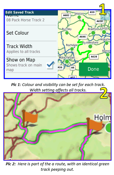

Three menu options of interest are shown in Pic 1:
