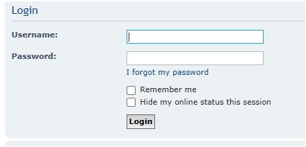

I spent about forty-five minutes drafting post but lost it when I tried to post it due to having been logged out. Apparently, typing and editing is not recognized as activity so the login times out. This can't apply to every forum member though considering the length of some of the posts.
Next time you log in, pause and click the 'Remember Me' box - before pressing Login.
That will stop it from logging out.
But the data entry form into which you type your repsonse, will still time out.
If it does, then tap the preview button. You may need to do it twice.
After that, you can submit you reply without losing anything.
The same applies when adding a picture - if the form has timed out when you add a picture, it will put an error symbol alongside the picture row.
Tap preview to reestabalish the connection. You may need to do it twice, and upload the picture again.
