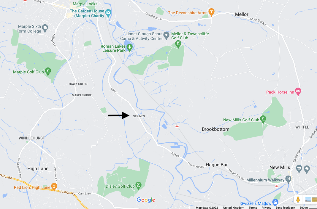

I think the point I was trying to make here, is that if we are in unknown territory, following a forced umleitung, which I have discovered these can be many miles. it is very easy to become disoriented and not know that turning left (in my example) takes you where you wanted to miss.
I am going to investigate this further, probably using edale, castleton, hope, snake pass etc, its possible to make some serious detours on this route and it will see how the XT plays up.
I was bit confused when you asked me about the strines road, having hairpins, then I realised you were talking about the road with the strines inn, and in answer to your question I have ridden it recently, it is a brilliant road, there are a couple of severe hairpins with cross camber thrown in for good measure, have to keep the revs up and be in correct gear or you're off.
Screenshot 2022-08-14 at 16.35.55.png (263.24 KiB) Viewed 1399 times
I thought you were talking about the road to Strines in between New Mills and Marple, not the most exiting route TBF😂
Screenshot 2022-08-14 at 16.47.38.png (435.93 KiB) Viewed 1399 times
