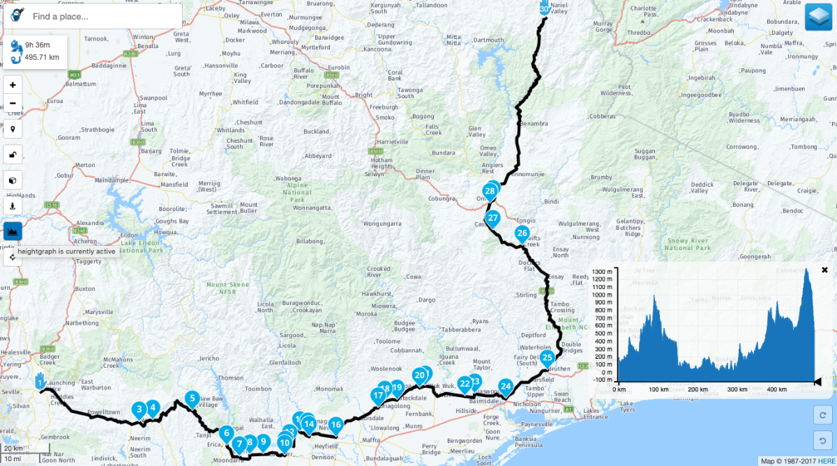

I'm with you. I know a start point and an endpoint and I use MyRouteApp to link the two using roads that look interesting, I don't worry about intermediate points as no software or paper map can tell me that I am going to come over a crest and see a fantastic view with perfect light that just begs for a photo to be taken or that I am thirsty or need a stretch and can see a nice looking little local cafe coming up ahead. When I do multi day rides I do each day as a separate route so if I decide to change things I find it easier to adjust and there is less chance of screwing up the whole ride route.
With MyRouteApp being able to create the routes on a laptop or tablet means you can see the big picture as you say but you can also zoom in and make sure you have complex travel through built up areas planned accurately.
I know other software can do the same or similar but I just find that this solution works well for me.
FWIW this is day one of a two day ride next week. 495km (about 150km of dirt road included) from the meeting spot to a campsite beside a river in the middle of nowhere. Day two will be 400km to Bright followed by marshalling a bicycle event on day 4 then day 5 will be another 400km route home. From the time I leave home on day one I won't see a traffic light until about 30km from home on day 5! :D
The zoomed in image will give you some idea of the great motorcycle roads.
Screen Shot 2022-01-13 at 9.18.12 am.png (381.42 KiB) Viewed 7813 times
Screen Shot 2022-01-13 at 9.11.24 am.png (1.38 MiB) Viewed 7813 times
