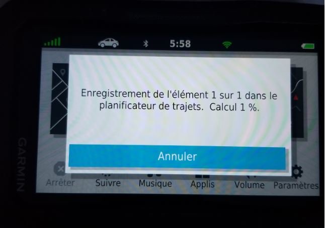

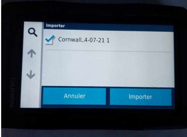

So here are some attached photos of what happens during my transfer. Sorry for the French in the pictures, but I'm sure you will understand.jfheath wrote: Thu Jul 22, 2021 9:56 pm 2. The route that you create on Basecamp should transfer and follow exactly the same route when it arrives on the XT. If it doesn't, then it has recalculated. Different maps and the edit, option, device transfer settings are two likely culprits. But so are a few other things, when starting the route.
My Zumo recalculation

Some calculation always pops up on the screen. It may say 35% 81% and then it will be done. It doesn't take long - 2 to 5 seconds on the routes that I have just tried. This is not an issue - it is importing the route and saving it somewher where it can find it. It is also pulling out key information from the route - like the waypoints for example, or the category names - all of which are embedded in the temp.gpx file that contains the routes that were transferred.
If it is calculating the entire route, you can expect it to take 30 seconds or more per route. You will know. It is very noticeably longer than normal.

When the route is transferred to Zumo Internal storage, it copies any Waypoints (created in Basecamp with the Flag tool) to the Zumo list of Favourites or Stored Locations. (Enregistre), and it makes the route / Trip available for Import.
With the Zumo in your hand, it may be set to Car and Shortest Distance.
When you load your route (which was set by Basecamp to Motorcycle and Fastest Time), then your Zumo switches to using Motorcycle and Fastest Time. Your Garmin route will remain as it was in BAsecamp. But if it needs to recalculate. (If you press 'Skip'; if you ride away from the magenta route), then the Zumo will have to calculate a new route from where you are to the next route point.
In order to do that it uses its current settings. Those are - Fastest Time, and Motorcycle.
Basecamp didn't send it any information about the motorcycle, so the Zumo uses what you have programmed it to use.
