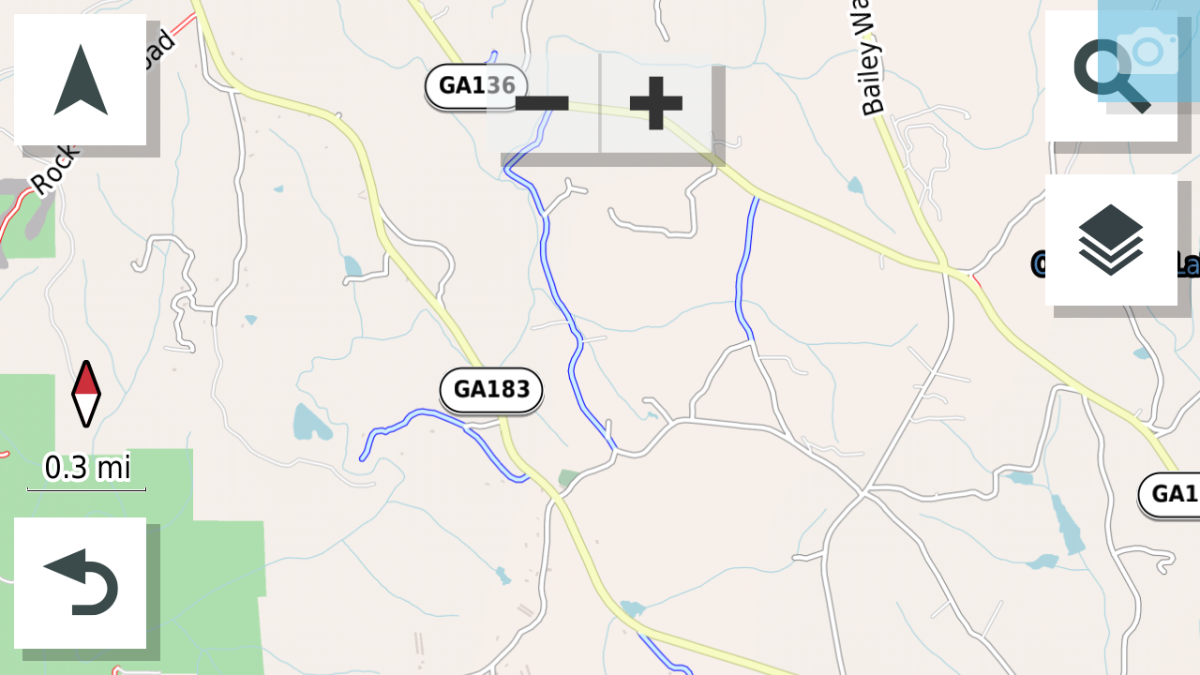

I'm new to the Garmin XT. I've been using it for about 3 months and so far have resisted the urge to toss it in the ditch. I use MyRoute-App to create my rides, and to avoid getting onto an unpaved road I use satellite view for a questionable road and can usually tell if it is unpaved by looking at the edges and/or the color. I have the avoidances on my XT set to avoid unpaved roads but it does no good. When I have sometimes have to deviate from my route the XT will prompt me to make a U-turn on one unpaved road after another. Evidently it has no clue between paved and unpaved, unless I am missing something.
