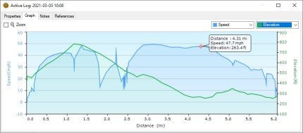

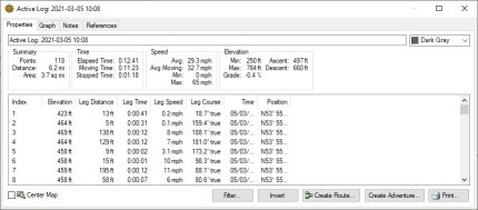

This shows the first few entries of a list that has about 1500 entries and covers about 77 miles. At the top of that window is a tab for Graph. You can select speed or elevation. Alongside is another dropdown so you can super impose Speed on top of Elevation. Or vice versa. As you move the mouse along the graph, a figure moves along the track to indicate where on the map that point is.

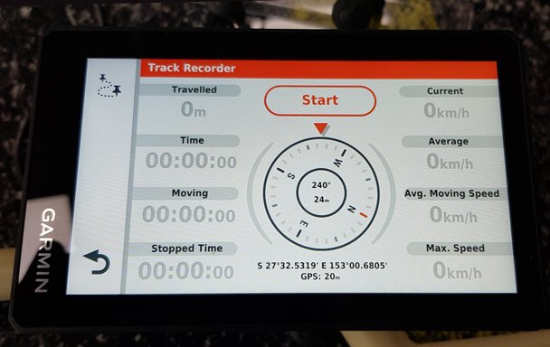

I wish I saw this before
I was debating between Garmin and Tomtom and Track Recording was one of the reasons why I got the Garmin.
However, I can't find a way to see the average moving speed or max speed (in Garmin Explore, it does show the basic data). I am really bumed out, is there any way of seeing this view again from saved tracks?

The data is all there in the GPX (which is only ever "You were at this point at this time" etc).
It's just that the Zumo XT interface doesn't show it. If we're hopeful, maybe they'll do it in a firmware update. But I won't hold my breath
Re: Saved track statistics

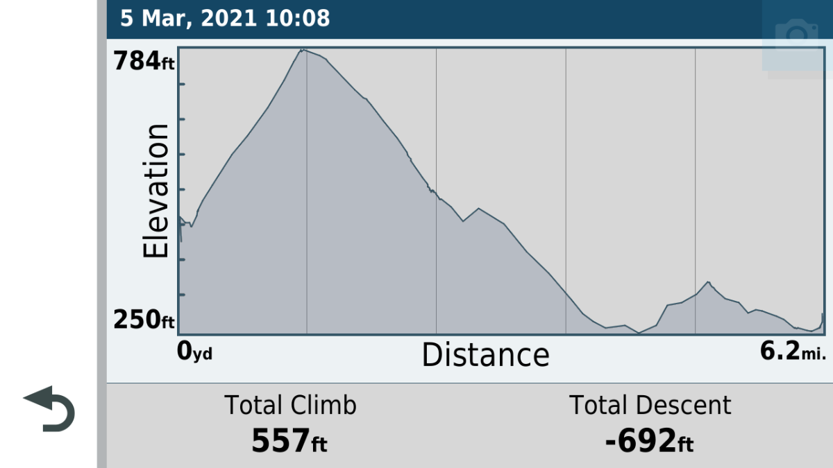

You can get an elevation profile by loading the tracks app - as in your picture, click the track icon in the top left corner and on the right hand side you have two tabs - top one represents tracks you have recorded with the app, the bottom one gives access to the tracks that are always being recorded - these are listed by date, and there may be a few for the same date. Click on one of them, and it shows the track on the map. Click the spanner, top left corner and there is an option to show the elevation profile.
Like this.

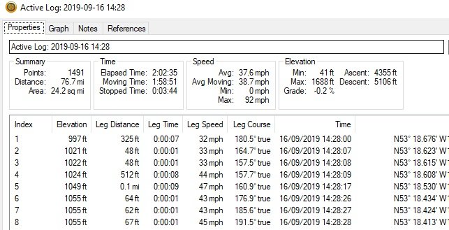

Double click the track - either on the map or by its name in the lower left hand window of Basecamp, and you get a table which looks like this
Which gives you elevation, time, speed, course, date, position. You can select this and copy the entire table to paste into a spreadhseet if you are so inclined. (Click on a row in the table, CTRL-A to select all, CTRL-C to copy to the clipboard).
Or double click on a row, and the map will zoom into that point to show you where you were doing 187mph.

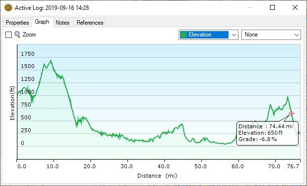

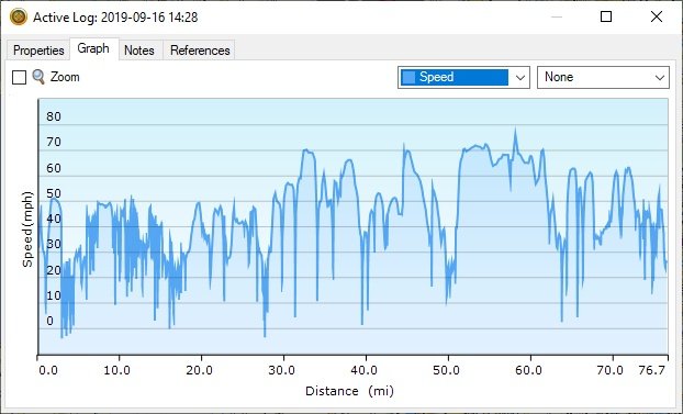

At the top, there is a tab - Graph.
Click that tab and it will give a speed or elevation profile. You can choose which one from the frist drop down list on the right. You can add the other to the same graph by choosing it from the second drop down list.
Like this

Like this.
However, a better bet is to use Basecamp. I don't know how much experience you have with it, but when you connect a PC to the XT with a USB cable, you can see the contents of your XTs memory, lower pane, left hand side. I don't know where the recorded tracks are shown - I guess they will appear in the same window, but the always-being-recorded Active Logs are in there.
Like this
