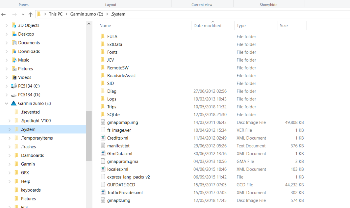

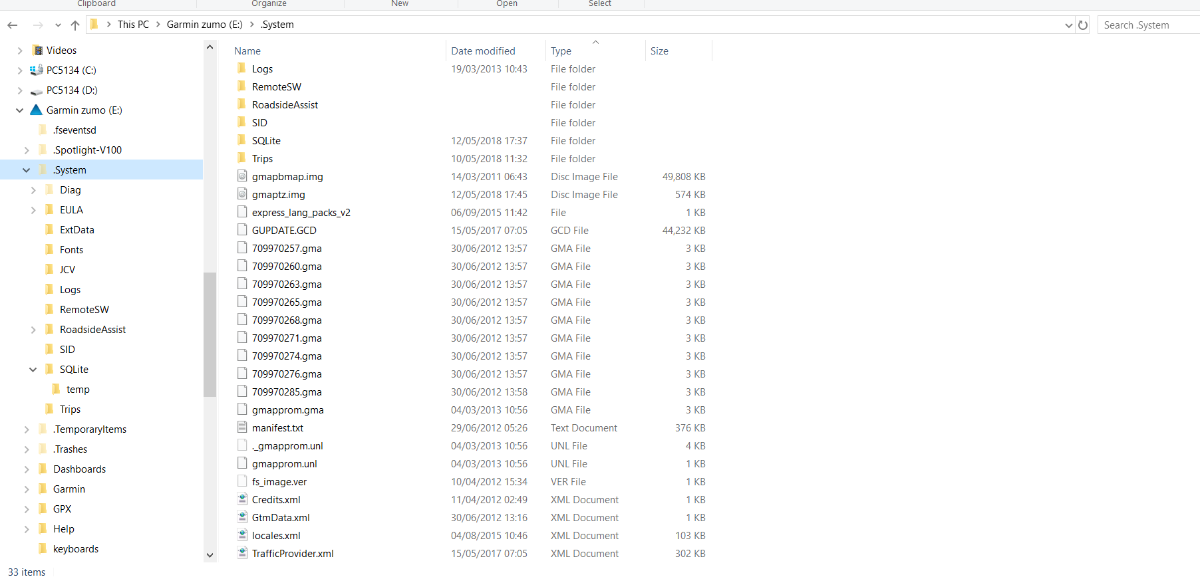

this is a pic of the files in the .system folder.
no sign of a gmapprom.img file.
Express did complete the install, but I did not do a safe eject (mea culpa).
have rebooted zumo, and there is absolutely nothing showing in Settings, Map & Vehicles, myMaps? just white screen.
Re: How to put maps onto your PC
You can delete all those .gma and .unl files. Try sending the map again but do a safe eject, if the map file is still being written by Windows it'll corrupt and won't work. If still no joy pm me your email and I'll send the files directly for you to copy and place in the .system folder

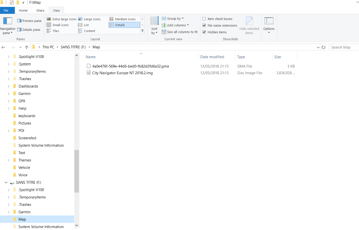

OK, so the internal memory looks like this.
and the memory card looks like this.
this was after using mapinstall (whilst the memory card was in the zumo) to get the 2018.20 onto the zumo. and on the zumo itself I can see under settings - my installed maps that the 2018.20 is present.
but in file manager (the pics I uploaded above) the map seems to be on the memory card. If I had done mapinstall with the memory card removed from the zumo, would the 2018.20 map be in the internal memory?
when I just sent a route from BC to device, BC shows a message saying that the route will be recalculated because it was created in a different map version. I only have (now) 2018.20 installed on the pc for BC. and i'm pretty sure the route I sent to device was created in 2018.20.
BC still shows only the worldwide autoroute DEM Basemap NR v5.01 as the map on the internal memory.
should I try to remove the img and gma or unl files from the memory card, remove the memory card, and then use mapinstall to transfer the 2018.20 map to the internal memory?
Progress at last :)
Those files on the card correspond exactly to what I got so you now have the map installed correctly.
As for where it is, MapInstall will install the map to where you select, so you must have selected the card?
FYI Express doesn't give you the option, it would normally install to the Zumo and not the card if there is sufficient space on the Zumo, otherwise it would choose the card.
Note if you're not seeing the map in BaseCamp run Express and under Install options select Install to computer.

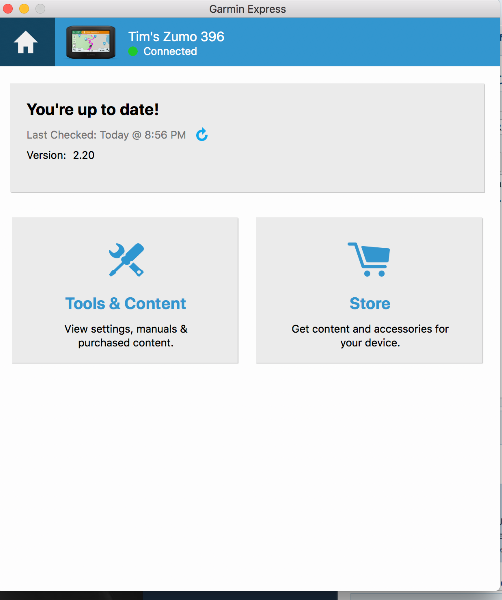

Not to hijack this thread to a MAC thread, but I have a quick question that perhaps you more experienced user can answer. So I have a new Zumo 596 with the North America map. When I connect to Garmin Express, it does not show the maps I have and in turn, I don't get the option of transferring my map to my computer and Basecamp. Any ideas? I'm wondering if Garmin has done this purposely? I've deleted and reinstalled express just to be sure. I'm stumped, as I can't seem to get the map to my computer.... at least not simply.
Thanks in advance.
Screen Shot 2018-05-12 at 9.08.12 PM.png (167.67 KiB) Viewed 7414 times
Express won't show your original map, you'll only get the options in Express when the next and subsequent maps are released.
