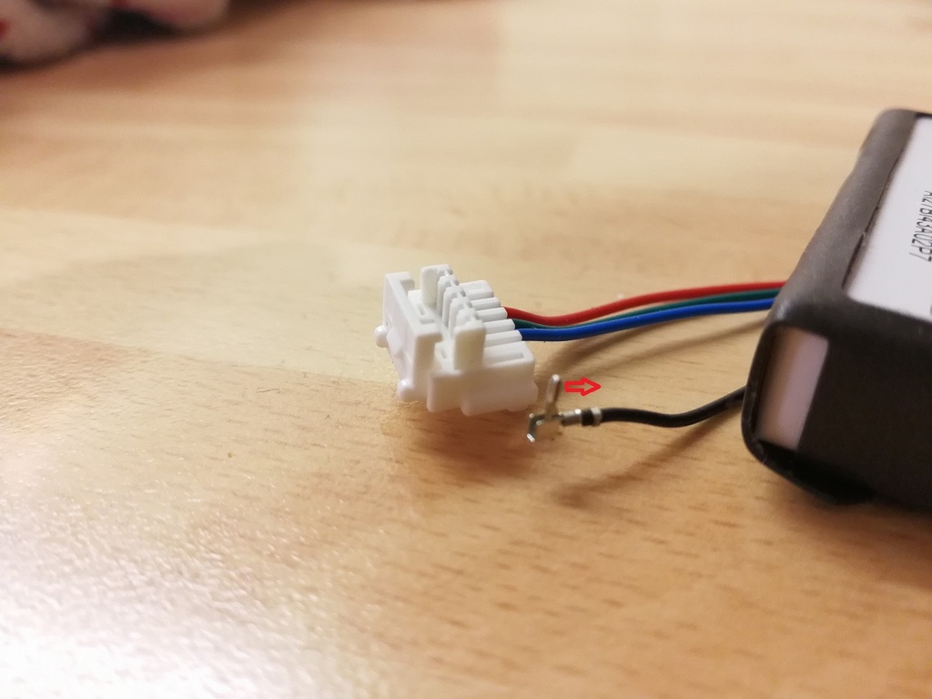

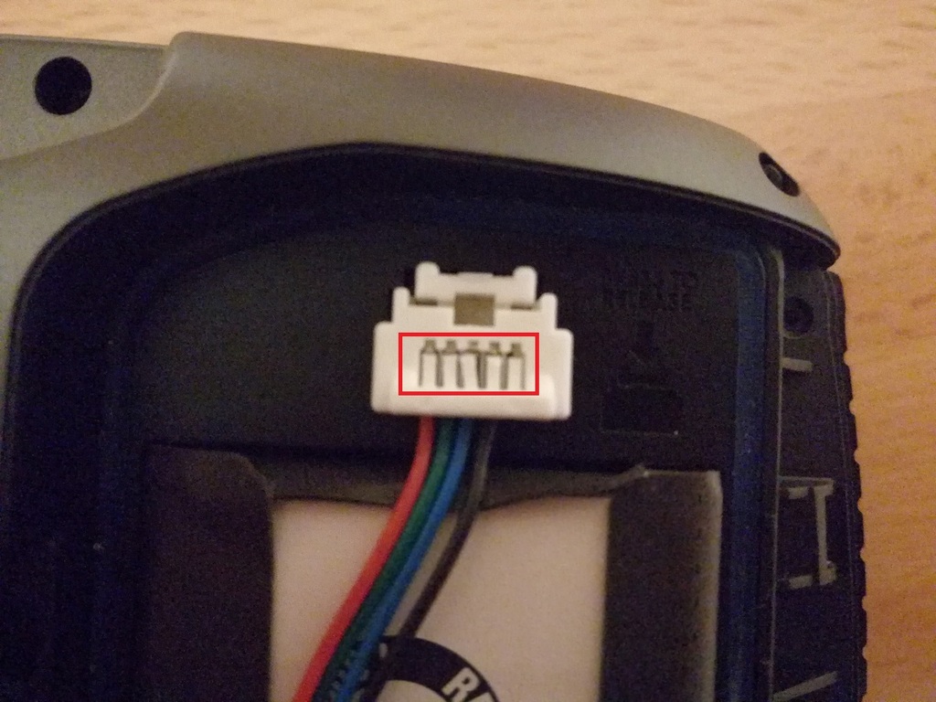

If you look at the connector on the battery you will see 5 small tabs.You need to lift these and pull the wire and pin out of the connector block. Be careful as they are a little delicate you can see that one of mine is a bit bent as I was a bit rough.
Once removed you need to bend the pin very slightly in the direction shown here. Be careful not to over do it and keep the pin straight as they easily go off centre.
Ensure the tab is straight and pushed back down on the connector block then insert the pin and wire back in to its slot ensuring it is fully home give it a little tug to make sure it is.
You could also probably go in from the back of the connector block with a pin and bend the connector pin but I removed them as I also wanted to give them a clean

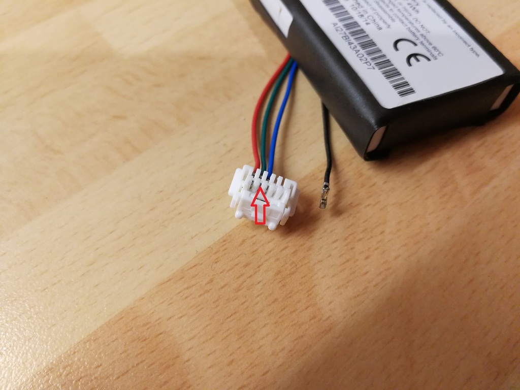

My fix is slightly more pin-friendly and reduces the risk of bending a pin too much (and crushing or snapping it) and provides improved contact on both sides of the pin and it's mating half, as it should have been at point of manufacture. It's fairly easy to do, you just need a steady hand and good eyesight (or some kind of magnification - close-up pictures here are from a cheap USB microscope).
Step-by-step:
1. Remove battery. Press down tab and lift out connector.
2. Remove a pin (one at a time to avoid short-circuit or mixing up the sequence) by using either a pin, small jewellers flat-blade screwdriver or the blade of your scalpel/X-Acto knife to carefully lift the tiny pin-retention tab on the connector housing. Gently pull the wire at the same time and it will slide out.
3. Insert the knife blade between the "sprung" contact surfaces, either side of the pin and "lean" the blade over slightly (both ways) to expand the gap, it doesn't need much.
4. Re-insert the pin in to the connector housing, ensure the tab is pushed back down.
5. Repeat 2-4 for all pins.
6. Re-insert battery, switch on and you should see an immediate improvement.
Gar01821's pin trick (not needing to remove the pins) should be used with care; don't bend the pin too far. But it is quicker and easier.
Step-by-step:
