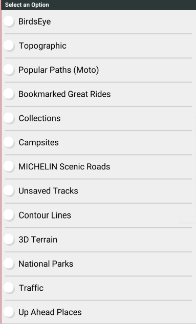

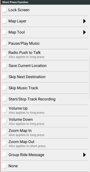

Re: Handlebar Controller for XT2
Available Button Press Functions
Images
Map Layer functions
Map Tools Functions
Images
Map Layer functions
Map Tools Functions
