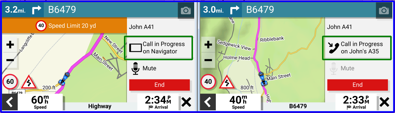

I also noticed something else - that didn't work on the old phone -'cos phone calls didn't work. When a call is in progress, the left hand screen below is shown.
This is me using two phones, calling myself. My old Samsung is the A41, and I am calling my new Samsung A35. The A35 is connected by BT to the XT2 and the XT2 is connected by BT to the headset.
When the call comes through, the message 'Call in Progress on Navigator' appears - outlined in Green on my left hand side image. I've never bothered with this before - I don't know if that also appeared on the XT1. I know it didn't do anything when I pressed it when carrying out the above tests.
When the screen display shows this - the call is directed to the XT2 and the XT2 directs it to the headset.
If you press that 'button' that is outlined in Green - that changes. The call is now transferred back to the phone itself. No sound comes through the earphones in the helmet, and the voice from microphone in the headset can not be heard at the other phone. Instead, the phone in your jacket pocket is now talking to the caller.
The second screen confirms this and now shows that 'Call is in Progress' on John's A35. This is the phone that I pair with the XT2. Except that it is no longer paired. Press that again, and pairing returns to between A35 and headset is re-established.
