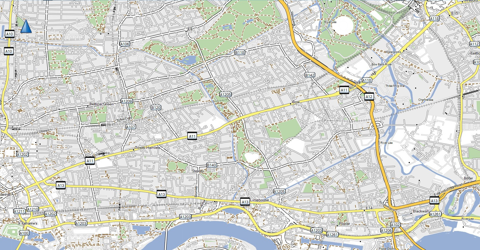

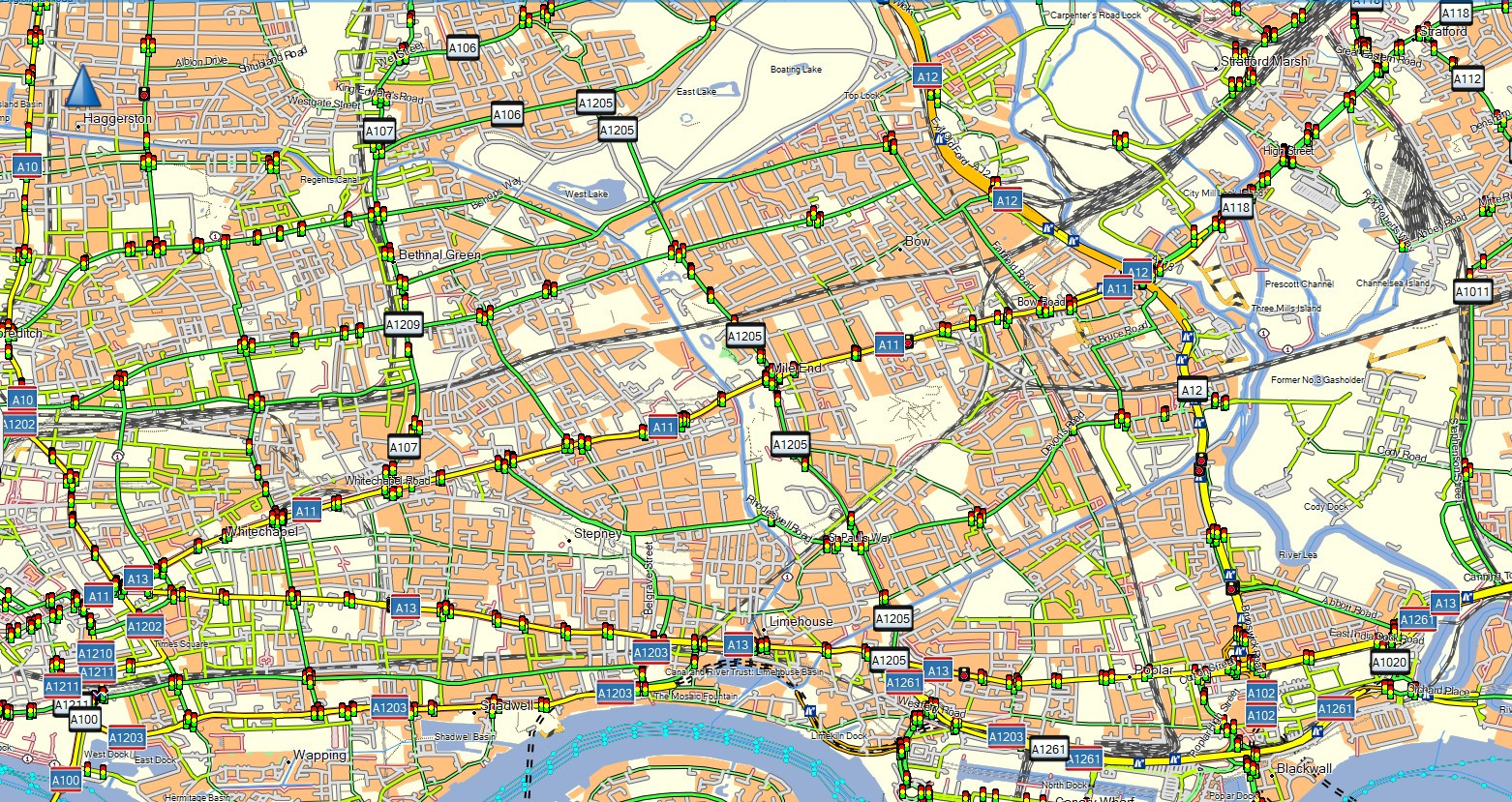

Re: Display traffic lights?
The first thing to ask. Does the selected map have that info? For CN Europe the answer is no. I have seen maps created from OpenStreetMap that do have traffic lights, and they show up on the XT(2) (I think so, but will check that later). But they play no role in routing.
EDIT: No, they dont show up on the XT.
Dont have acces to my XT, but here is a sample from BaseCamp:
Some location with the CN map:
