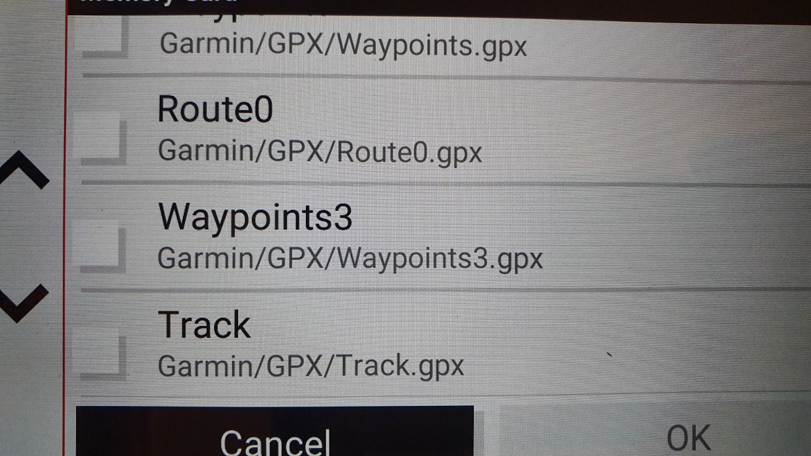

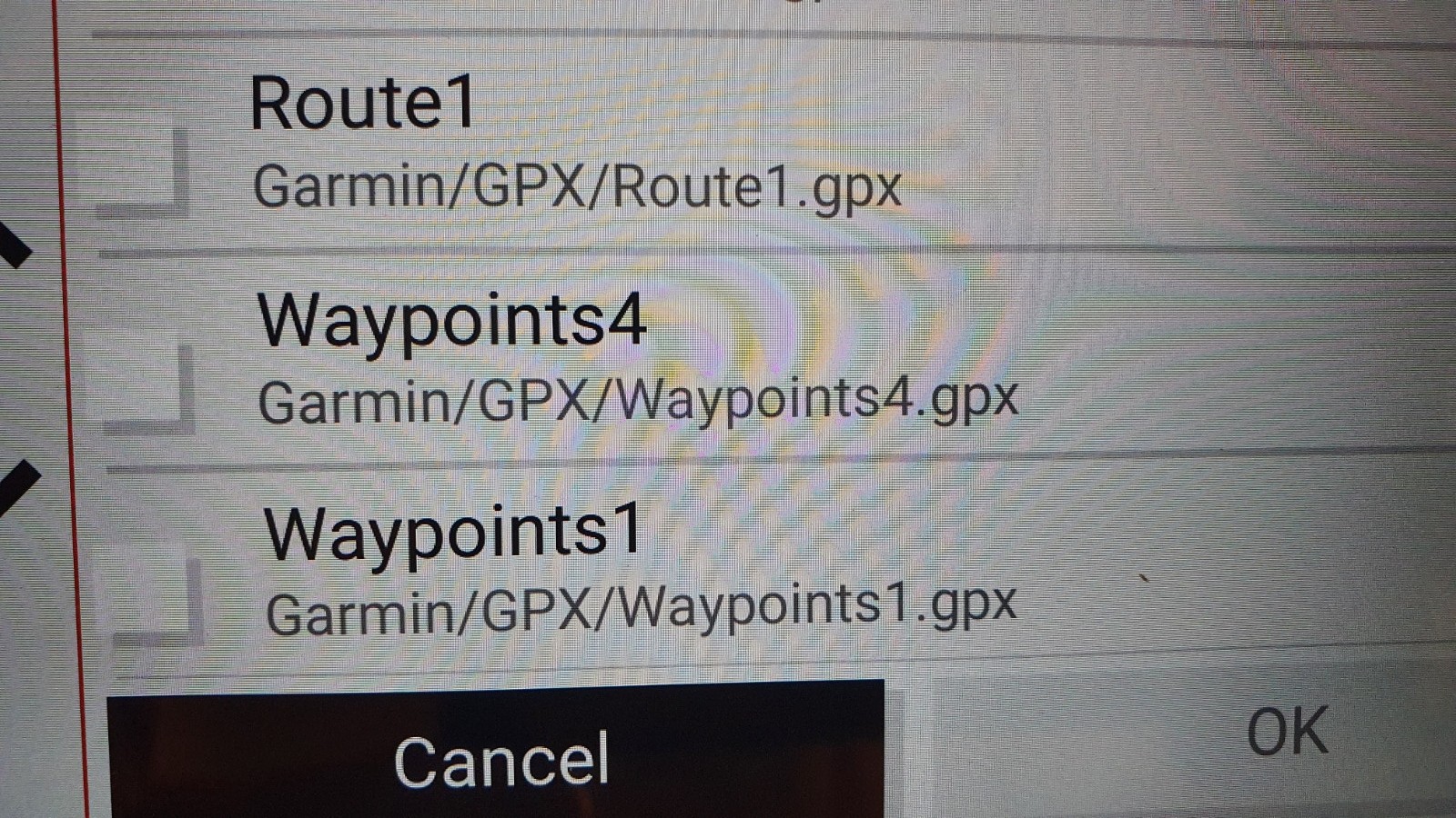

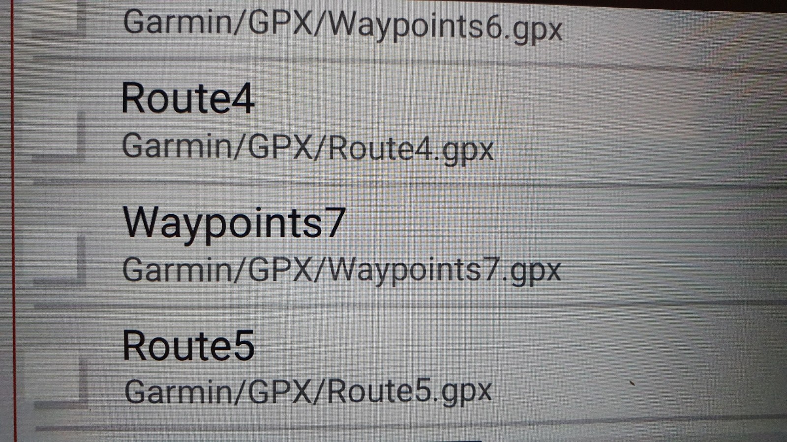

I've seen on here that when transferring routes from Basecamp to the XT2 it gives them random names. I'm beginning to realise how frustrating this is. I have some routes and tracks on my XT2 (on the memory card) and I'm importing one new route. The photo below shows some of the choices I have when I answer "Yes" to Importing the new file. How am I supposed to know from the list shown which one is my new Route (and which Waypoints are associated with it?).
Also, is there a correct way of deleting files off the unit? (from the unit itself or with File Explorer when connected to a pc?)
Apologies for the upside down photos, it's been a long day!
How do I know what to Import?

Each track is individually taken from the transfer file and placed in its own separate gpx file. The name given to the file is identical to the name of the track as shown above. Don't get too excited by that though, these files disappear as soon as the track has been imported.
The Waypoints are all extracted and automatically placed in the Waypoints category.
The Routes remain in temp.gpx and can be imported from there. So you still do not know what the route is called until you inititate the import - and then the XT2 displays the route name and allows you to select which ones to import.

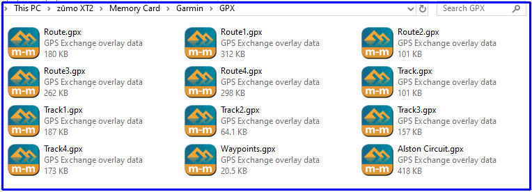

If you send the files to the SD Card, then behaviour is somewhat different. The Zumo have never tried to do anything with the contents of the SD card - so they can create a file and put a route in it - but they cannot alter the contents or alter the filename. Since they cannot find out the name of the route before the file has been created - they have to resort to calling the files by number. Route1.gpx (which is the 2nd route, not the first. The first is called Route.gpx
This isn't an XT2 quirk. This has happened for a long time and is documented in my notes on Basecamp and Zumo 590/595 Pages 21 and 22
A way around this is to export separate GPX files and name them accordingly, and manually place them in the SD Card / GPX / folder.
Note that after import, there is a similar looking screen which asks you to say which collection you want to import the routes/tracks/waypoints to.
If you don't have any, then click 'New Collection' and call it 'All', or 'Everything'.

Thank you for the detailed reply! I always transfer my routes to the sd card so as to try and keep the internal memory free for map updates etc. So if I'm understanding you correctly, when transferring I should select the higher route/track numbers?
Eg if I'm transferring a single route and I see "Route 0, Route 1, Route 2" then Route 2 should be the correct one?

My process is to select the route I want to transfer to the SD card, go to File > Export > Export selection, and save that file to my PC hard drive (the default filename will be the route name). I then copy that file to the SD card. An advantage to this is that when you look at the \GPX folder on the SD card with a file explorer you can identity what each .gpx file contains based on the filename. This makes for easier cleanup after a multi-day trip when you only wish to delete the files associated with that trip from the SD card.

And putting files onto the SD card keeps them safe from the XT/XT2 from editing them. So the contents are always available to re-import.Peobody wrote: ↑Tue May 28, 2024 12:50 pm My process is to select the route I want to transfer to the SD card, go to File > Export > Export selection, and save that file to my PC hard drive (the default filename will be the route name). I then copy that file to the SD card. An advantage to this is that when you look at the \GPX folder on the SD card with a file explorer you can identity what each .gpx file contains based on the filename. This makes for easier cleanup after a multi-day trip when you only wish to delete the files associated with that trip from the SD card.
So you can delete routes, tracks and waypoints from the Zumo if you wish - they remain on the SD card to re-import.
The method @Peobody Describes is necessary to avoid the file sorting and naming that I illustrated in my previous post. (Route1, Route2 etc).
You can export as much as you want into a single GPX files - routes, tracks, waypoints - all together with one name if you wish.
